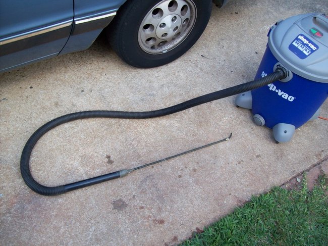

I need to drain the reservoir tank to add antifreeze. Does any one know how to do it that can explain to me please?

This might be an easy way.
Be sure to remove the vac's filter.
Use a piece of fuel line or vacuum line (instead of the steel brake line in my picture).
Duct tape/etc., the smaller line inside the hose, seal it off good.
Let us know how it goes.
