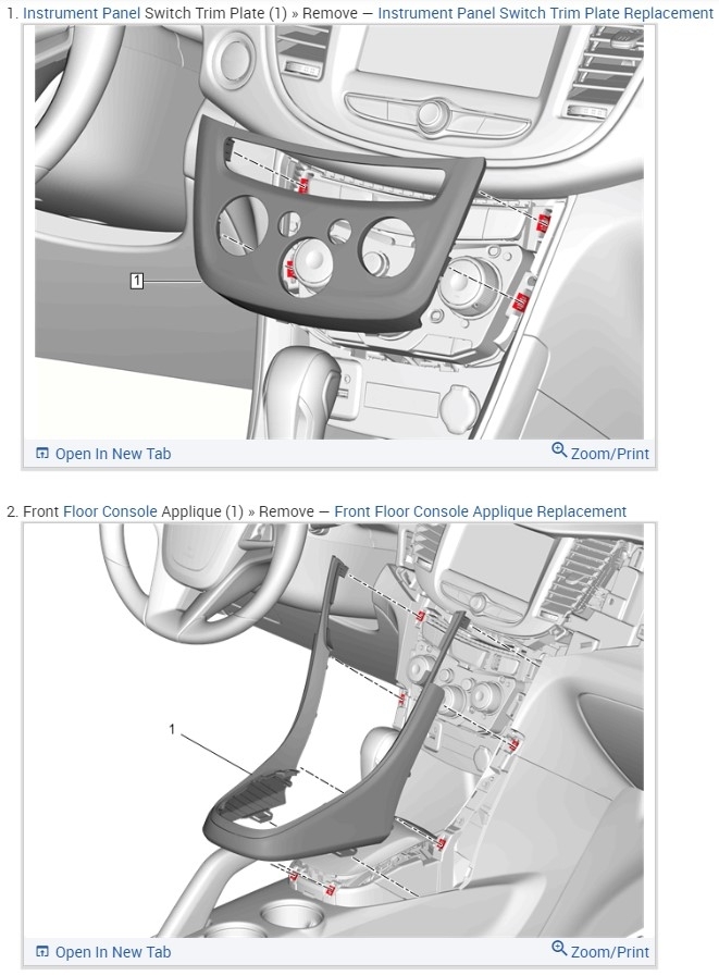

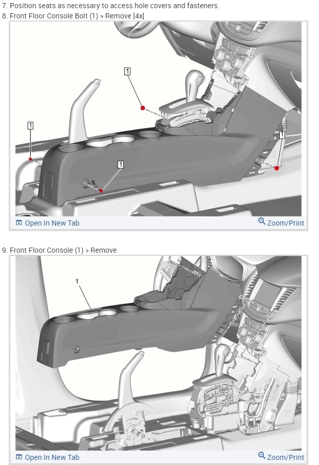

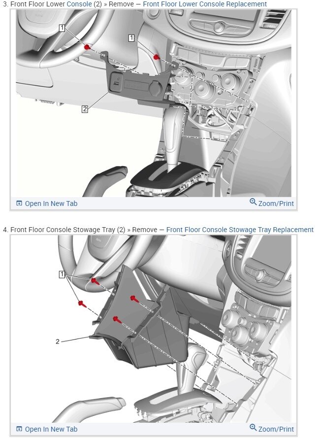

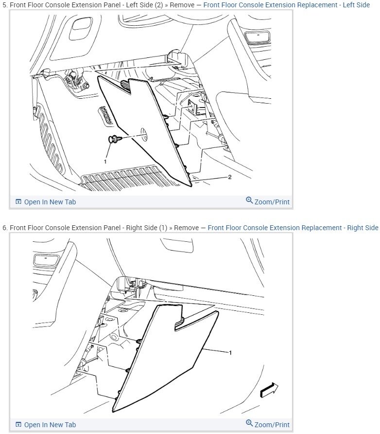

Dropped something downside of emergency brake and need to get it off.
Jul 25, 2023 at 7:48 PM
STEVE W.
  • 15,344 POSTS
First thing is to get a trim stick or similar pry tool as you need to remove a few trim panels. The pictures attached are the steps to get the console out. However, if the item is near the E-brake you might be able to remove the two screws at the rear of the console and gently lift it enough to get under it and fish out the item. May save you some time.
