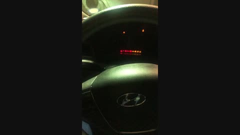

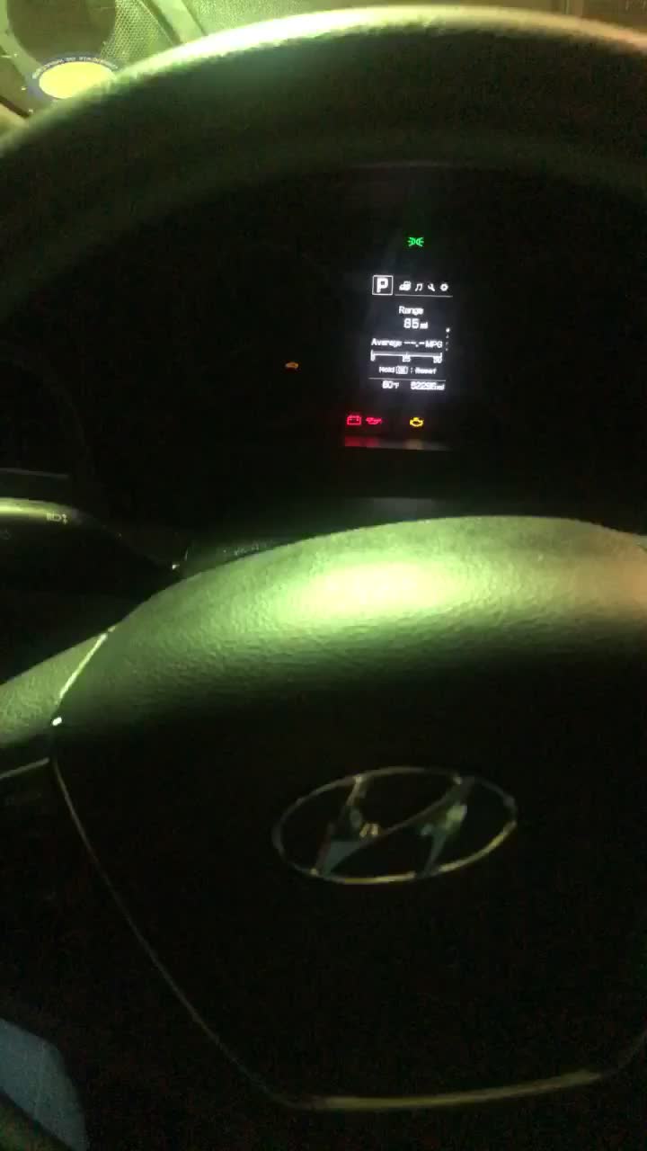

Today when I got in the car it turned on perfectly fine. I got off to get a coffee got back in and the car lasted the longest that its lasted to turn back on and got this. Also after it turned back on finally the engine light went on. Will take it to AutoZone to get light check out see what it detected but from this video any ideas?
Nov 19, 2019 at 11:18 PM
  • 110,244 POSTS
That appears to be a connection issue. First, confirm the battery terminals are clean and tight.
Let me know what is found.
