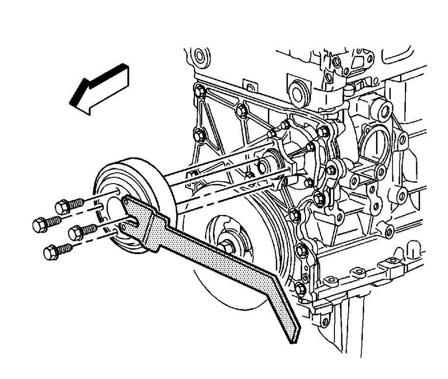

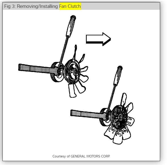

I have the vehicle listed above and seen a video that you had a pipe wrench to hold in place to take off plastic fan. What size is the pipe wrench you used to hold the pully and where do you put the pipe wrench to hold it in place. Also, what size of wrenches do you need to take off bolts? Would it be a 10" and 13' wrench for the water pump. Thank you for any information.
Feb 15, 2024 at 7:16 AM
  • 55,432 POSTS
They have a tool they you can borrow from the auto parts store, which is what I would use. here is an image of the tool set and instructions on how to remove the fan in the images below. That was a big pipe wrench FYI :) I am not sure where he got it.
https://amzn.to/4bDqbFM

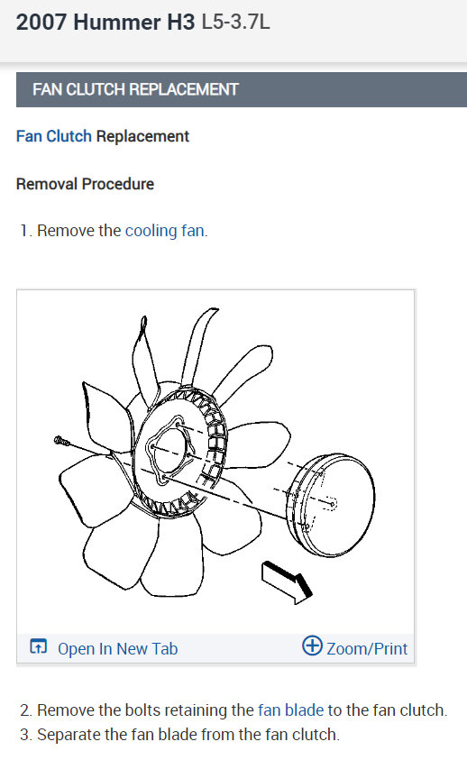

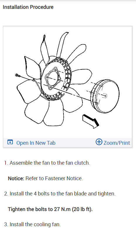

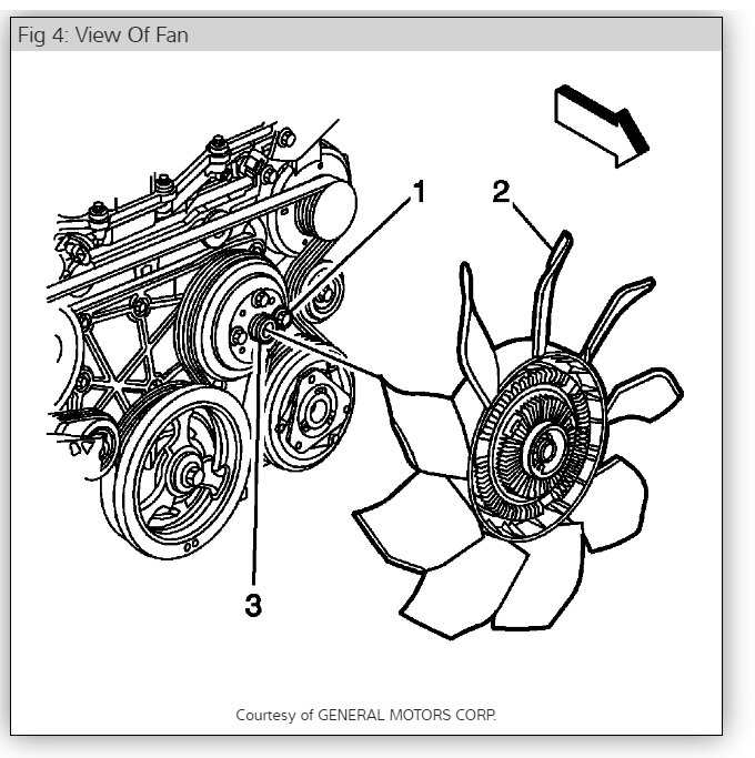

This guide may help as well:
https://www.2carpros.com/articles/fan-clutch-removal
Check out the images (below). Let us know how it goes.
