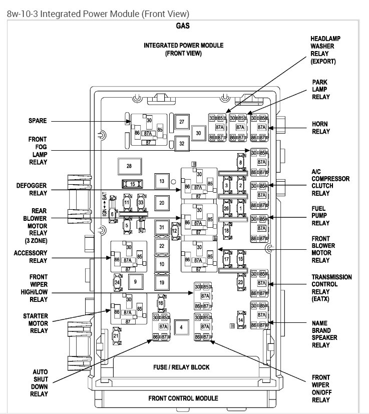

Why are the taillights not working?
210,000 MILES
TSTAN2179
But brake lights and turn signals are working. Please help.
Aug 11, 2022 at 10:16 PM
  • 55,691 POSTS
I would check the fuses # 2 and #3 in the under-hood fuse panel and if they are okay replace the park lamp relay. here is a guide to help you check the fuses and the fuse and relay locations in the diagrams below:
