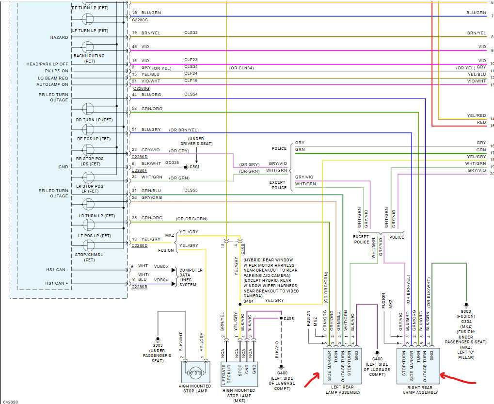

I want to make tuning for Taillight and install running lights. So, I need learning wiring diagram and pin placement. I hope for your support.

I'm trying to put the running turn signals on the rear lights.

Do you have an image? Doesn't it have lights already?

I plan to do like in this video

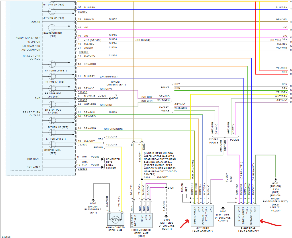

Gotcha, here are the wiring diagrams for the tail lights. Check out the images (below). Please upload pictures or videos in your response
