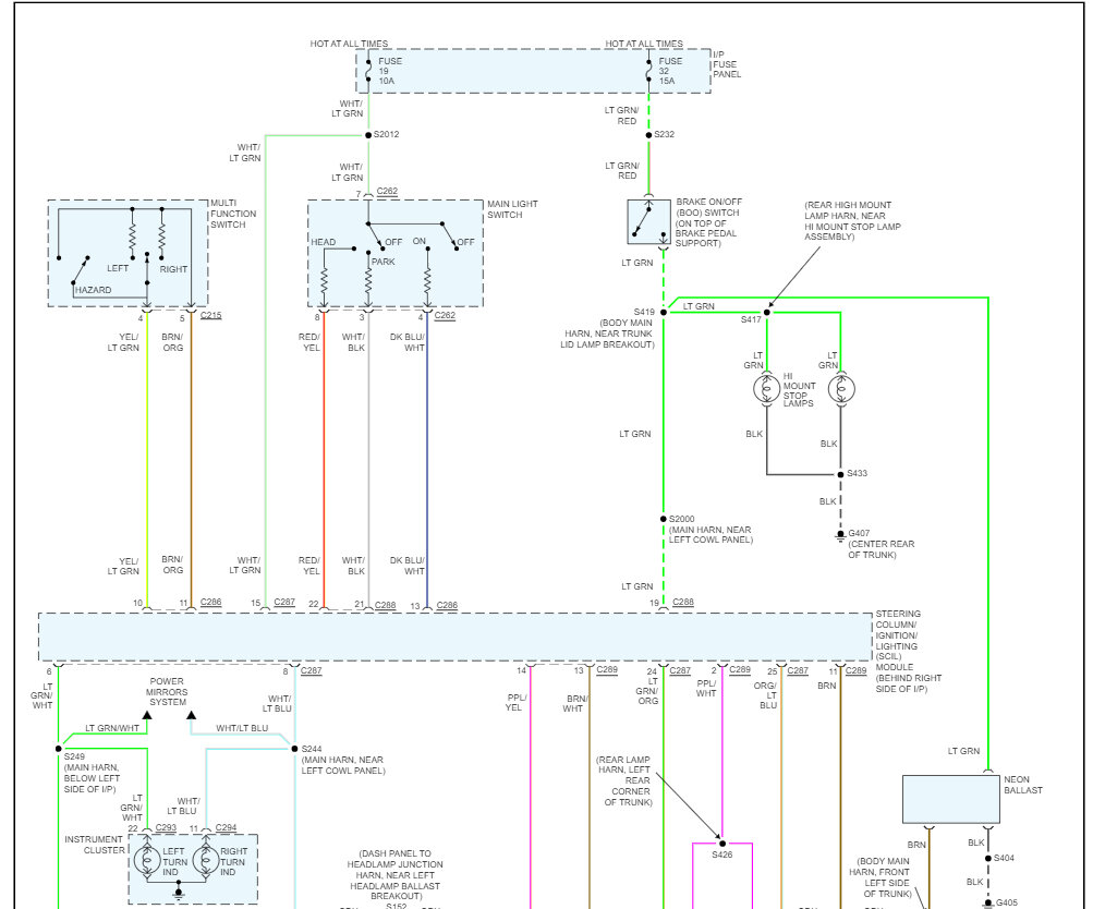

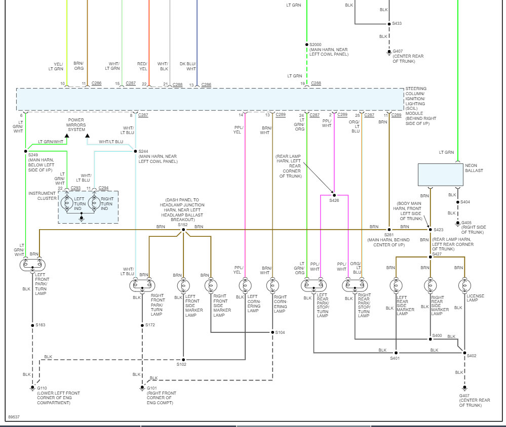

I just need the wiring diagram for the taillights, what colors goes where. Thank you!
Aug 14, 2023 at 5:58 AM
Experienced Mechanic
55,694 POSTS
Here are the taillight wiring diagrams and a guide to help you test the connections:
Check out the images (below). Please let us know if you need anything else to get the problem fixed.
