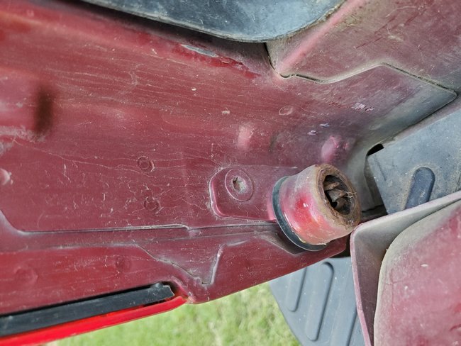

Pretty straight forward here. The hinge has broken away from the tailgate. I'd like to know what size torx head it takes to take it off (T55 is too big) and how do these things install? Picture below. Thank you

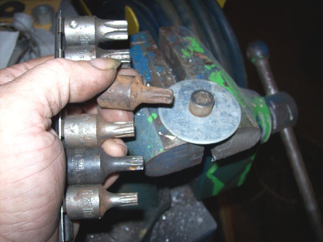

Size might be a trial and error kind of thing. A "set" of torx sockets is inexpensive at an auto parts store.

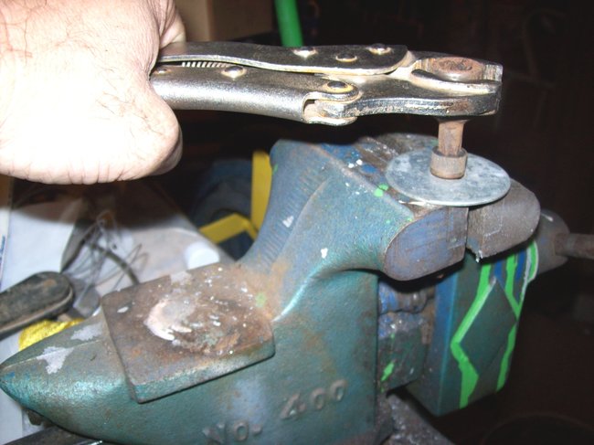

Bear with me, the first pic I show is a allen head, when I searched for a torx in my stuff, there were none!
This technique is going to be the same anyway.

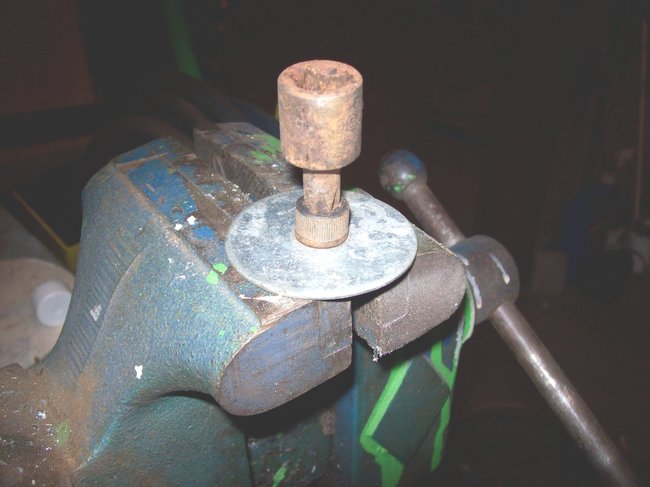

Pic 1) Select the correct size
Pic 2) Install the tool into the torx fastener

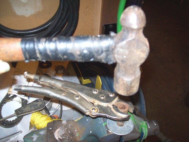

Pic 3) Lock vise grip pliers firmly onto the tool (using a ratchet usually results in a broken tool or stripped out fastener (star)
Pic 4) I only have two hands. I needed three for this pic. One to snap the pic, one to hold the hammer, one to apply pressure to the vise grips (not shown here).
So pull on the vise grips, hard pressure, we are not trying to turn the tool (or the fastener)! Just giving it pressure.
Hold the vise grip pressure and whack the torx socket repeatedly with the hammer. Eventually you will learn how hard to smack it when the fastener will finally begin to turn.
You can install the fastener back using a ratchet and some "blue" removable "Lock-tite" on the threads.
Pic 5) Not a single torx left in my Jeep!

A lot of emphasis on the size bit and removal of the torx screw. I believe it's a T50. I really want to know is if it's an easy install and can I do it without taking the entire tail gate off. There is some slack I can work around, with the other still attached. When it comes to removing the screws, I'll put some heat on it if I have to.

In my opinion,this would be a very easy repair.
The gate would have to come off.
I found several videos that will surely inform you and aid in the repair.
