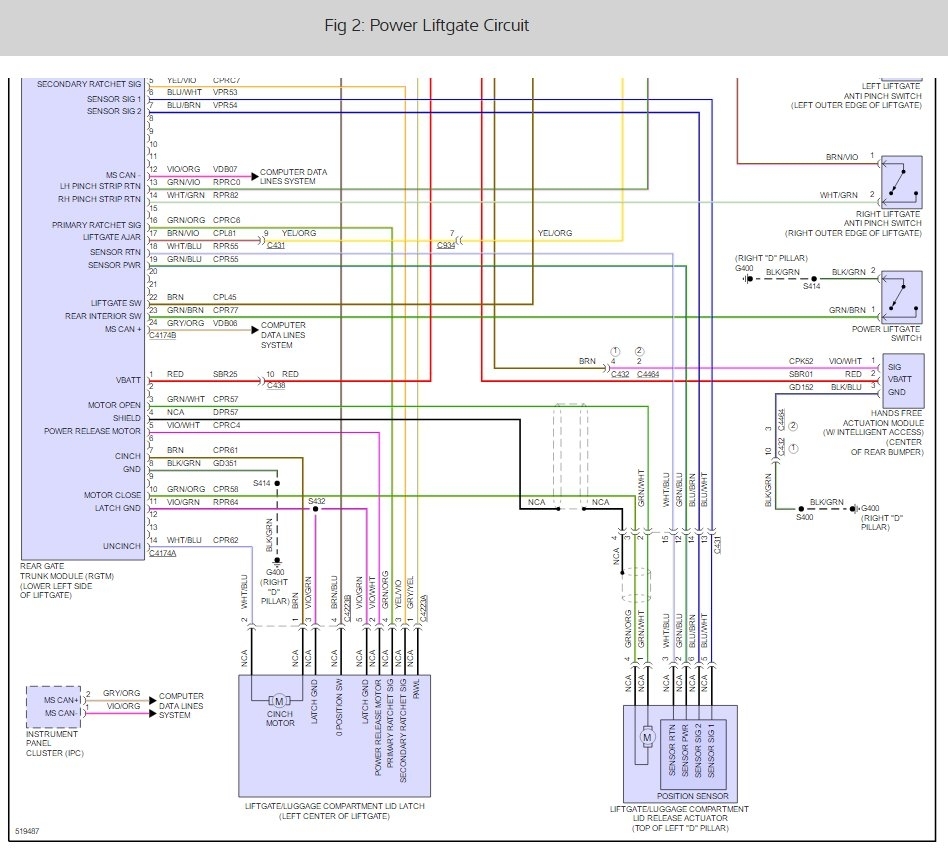

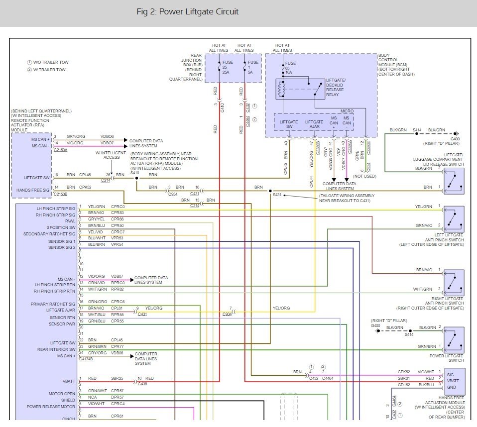

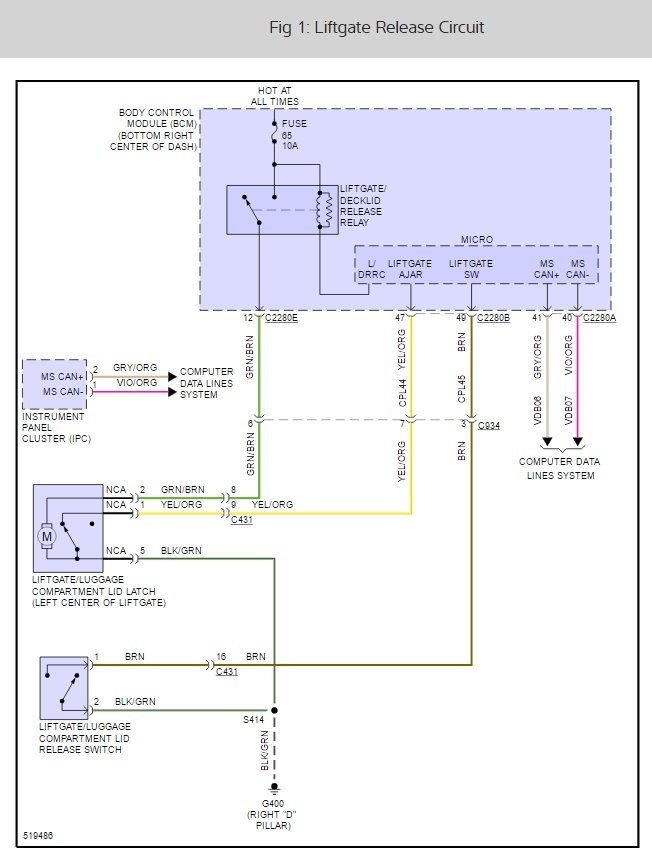

Tailgate seldom opens with foot action.
May 26, 2017 at 9:08 AM
Experienced Mechanic
55,684 POSTS
There is a tail gate relay that sounds like is acting up. Here is a guide and some tailgate wiring diagram to help you do some testing and get the problem fixed.
and
Please run some tests and get back to us so we can continue helping you.
