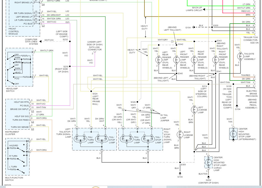

Yesterday the passenger park light was also on, and today it's now taillights and park lights. We know it's not the light switch or fuses.
Dec 20, 2022 at 10:04 PM
  • 110,240 POSTS

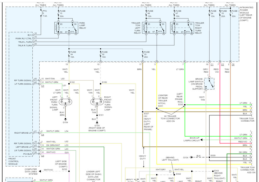

Park lamps use a driver in the front control module that is part of the TIPM (totally integrated power module). Power from the module is sent to a parking lamp relay and then through a fuse to the lamps.
I attached the wiring schematic below, so you have a reference. Here is what I want you to try. Disconnect the battery for about ten minutes and see if it resets the control module.
Let me know if that takes care of the issue.
