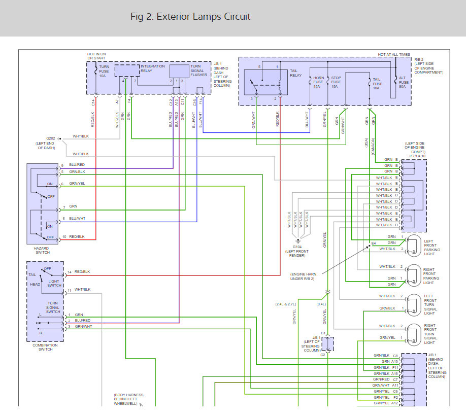

Taillights do not work when headlights are turned on
109,000 MILES • 2.4L • 4 CYL • 2WD • AUTOMATIC
SPARKY77
Ice or water got in a connection some place I think? Fuses are good? Short or connection problem? What is best place to start trouble shooting?
Feb 28, 2019 at 7:08 AM
  • 55,456 POSTS

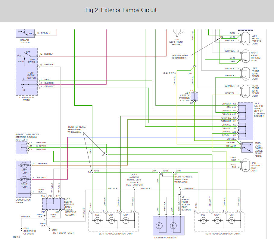

I would start with the tail light relay or combination switch. Here is a guide to help you get started with the tail light wiring diagrams so you can see how the system works:
and
https://www.2carpros.com/articles/no-tail-lights-exterior-running-lights-tail-lights-out
Mar 2, 2019 at 4:19 AM
