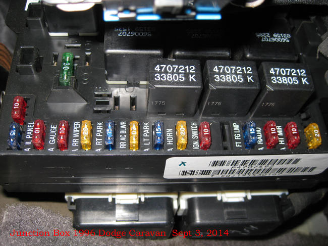

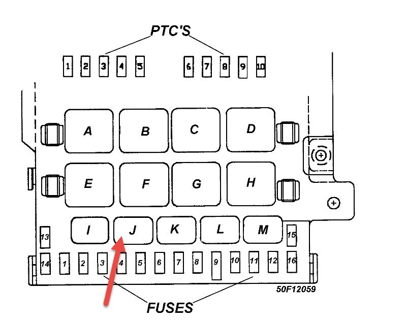

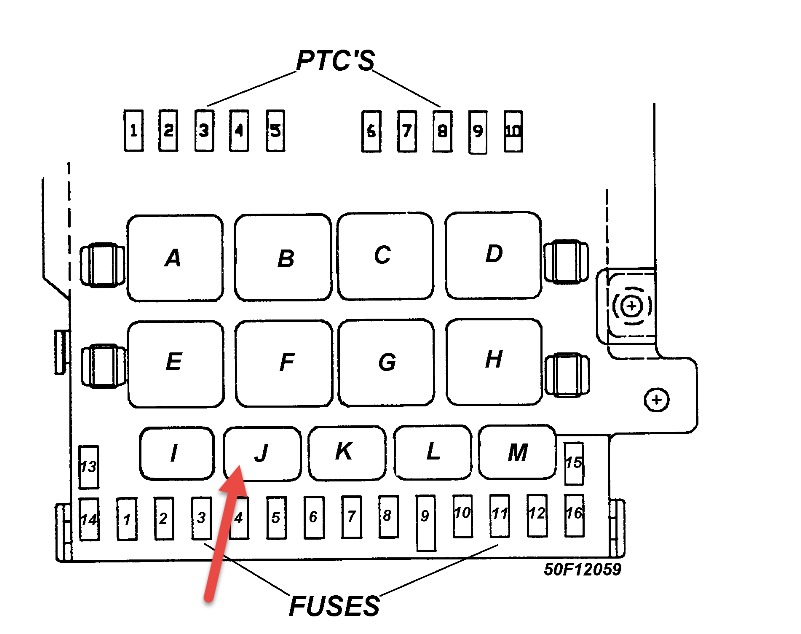

I have worked through all the schematics. I have been lead to look for the Park Light Relay and related fuses to solve this problem. The Haynes manual schematic says it should be power distribution center, but it isn't there. On your Web Page I found a 2010 Year answer listing referring to a diagram for the junction box and descriptions. That diagram shows four active relays J,K,L,M across the bottom of the junction box, with relay J to be the Park Light Relay. It also shows a total of 17 fuses. BUT, my junction box is different showing only three relays across the bottom and one fewer fuses. I removed all three relays and checked them with a DMM. The test data shows them all the same and OK. I pulled all the fuses that appear to be related to the issue: visually and low Ohms measurements show all to be good. I have attached a photo of the Junction Box if that will help. This 1996 Grand Caravan was one of the first off the assembly line. It was delivered to me new in September 1995. Any help that you can give this retired electronics engineer would be be much appreciated.

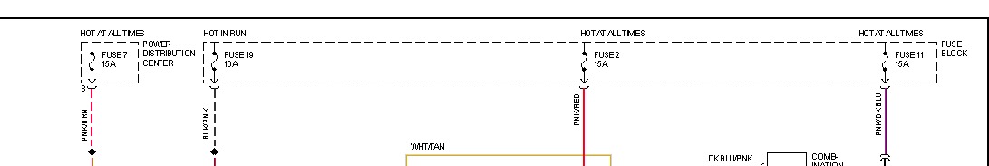

your power dist center shold be by the battery underhood. check fuses 6-15-16 there and 4&5 in side vehicle but have a pro scan it as it can be your body module and or drl module that is bad as those run most of the lights.

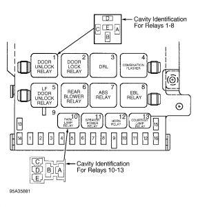

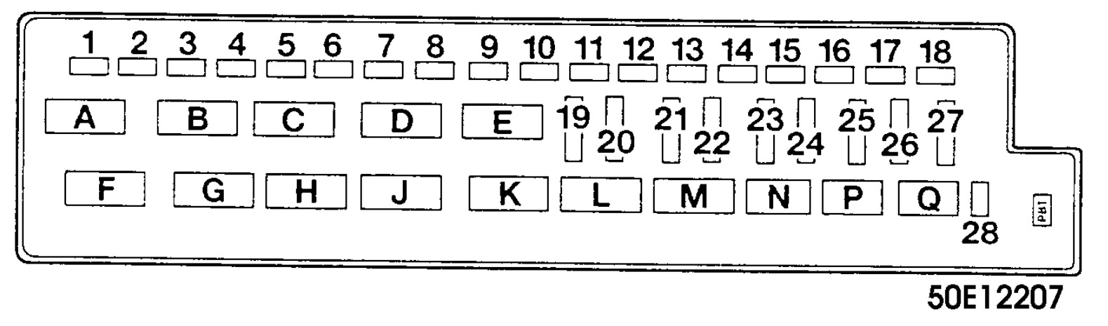

relooking at this issue as I didn't uflly read your question I looked under 95 and these fuse in pic are what you should check for some of the lights. however still have it scanned as it may be the body module see pic for 95 setup of fuses.

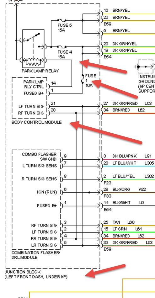

As for scanning, do you mean obtaining the codes from the Powertrain Control Module (PCM). If so, that has been done and the only results were 1-2 and 5-5 indicating all OK.
Is there another scan that would indicate a body module problem???
Do you have a diagram for the 1996 Dodge Caravan Body Module?

what photo? also the fuse that I posted on second rely were from a 95 as you stated that it's an early 96. BTW with these type of fuses it's a lot easier to use a test light in the future instead of trying to grab, pull and bust your fingers trying to get the darn things out. we don't get response form other vehicles only the ones we answer. the pic I'm sending now is from a 96 and yes you need a pro scanner to read any module in the vehicle he autoparts ones only read engine and trans. it clearly states junction block where the fuses and park light relay is. which I think you have already checked. hopefully my pic will come through this time lol.if not I can mail to your email

I posted a photo with my original question. Maybe you overlooked it or it didn't come through. It is a photo of the junction block in my car which is different than the one I found on your web page for the 1996 Dodge. I HAVE ATTACHED THEM HERE WITH THIS MESSAGE. So your schematic shows the relay but where is it physically in the Junction Box, the relays there are not labeled. If it is one of the small ones at the bottom, then the problem lies elsewhere.

on your second pic the one that the arrow points to is the tail light relay the two pics I'm sending are from the 96 one is junction block which J is relay for parking lights and the other one is poerdist center under hood.. Chrysler did a piss poor job of marking there boxes as yo need a whole page or moer so they say what they are instead of compacting it. If your truck is the jelly bean style then it's a 96 if it's square then it's a 95

If you take a good look at the photo I sent you of MY Junction Box, there are only three relays loaded on that first row. There are four in the diagram, therefore it does not describe my junction box as I pointed out from the beginning.
All three of those first row relays have been checked, any way.
I'll check some of the others above.
My Dodge G Caravan is the new one, 1996, Jelly Bean if you say so.
Looks like the documentation for this car does not match the hardware well.

the scanner will know the difference as they will punch in the vin number I still think it's the module problem. I think that the pic you sent as well as what I have are two in the same except yours is missing the park light relay which I'm assuming you have owned this for a while an d they worked prior to this. I've run into a couple of instances where our manuals are wrong. this is really screwy i'll tell you. If you wan tyour donation back let me know and i'll see it done

Based on your schematic and diagram, I moved the relay #11 to the blank relay #10 position and all the missing lights came on.
The relay probably had been mislocated some time ago.
