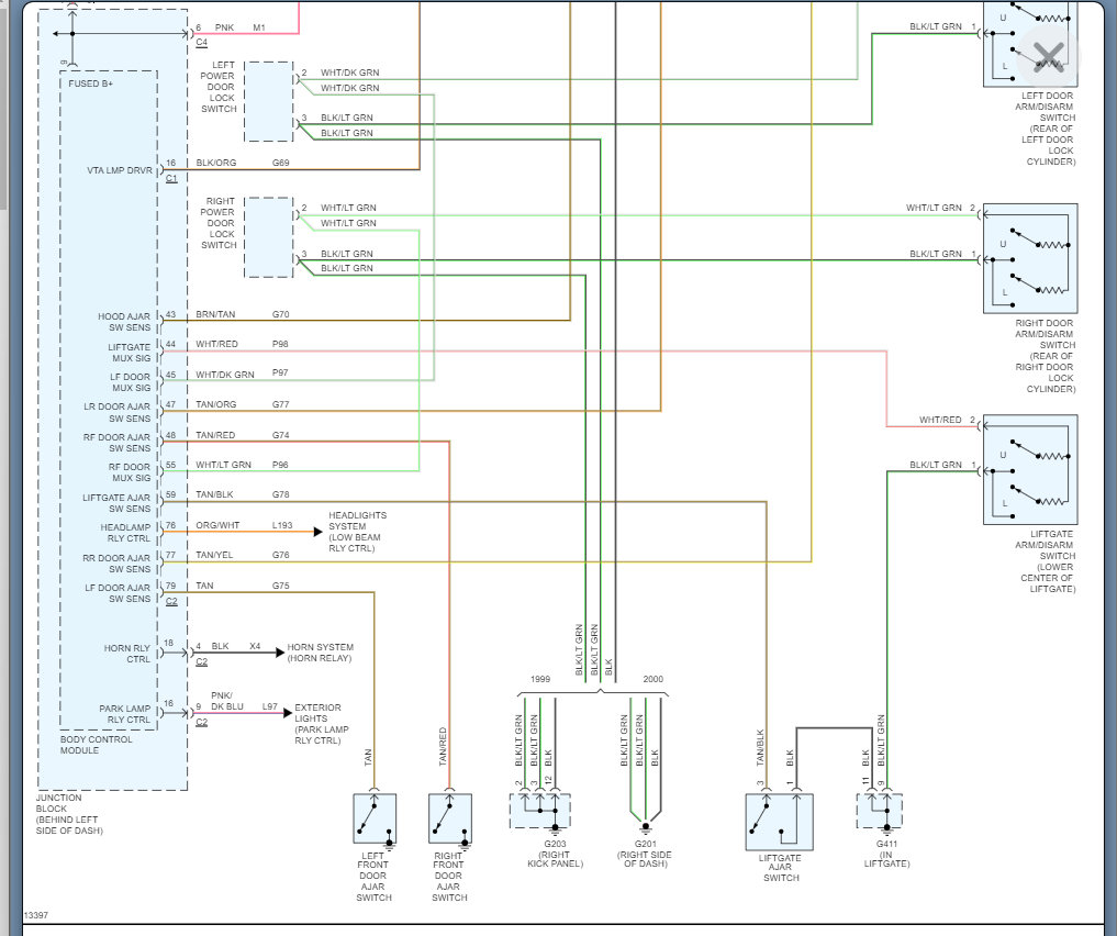

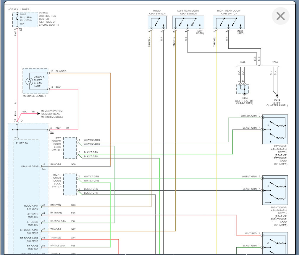

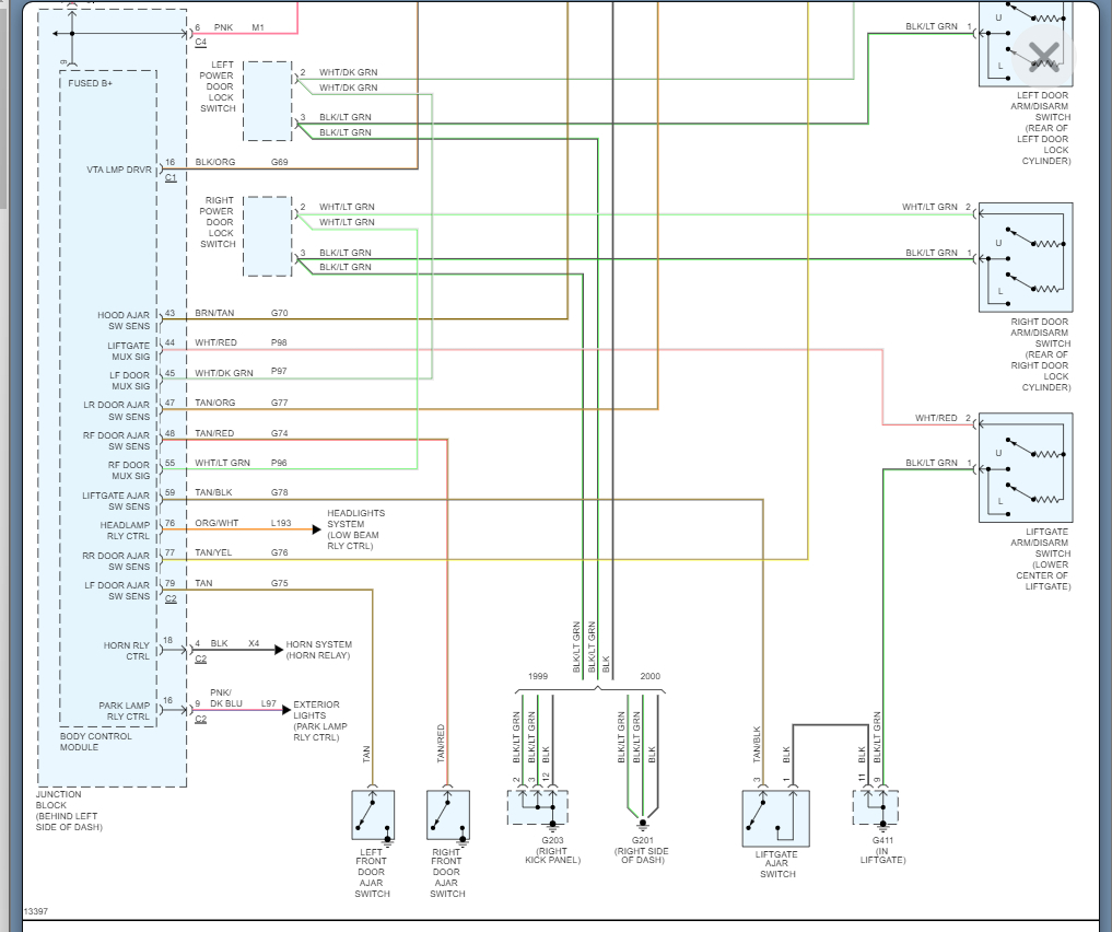

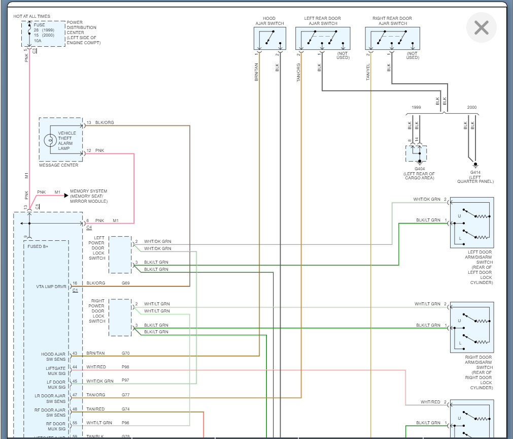

Below you will find the wiring diagram that will also help with this as we need to suspect the BCM is the issue if you are not able to disarm it.
Basically, we need to check the inputs to the system and find out if any are telling the BCM that the alarm should be on.
Basically, we need to check the voltage on the arm disarm switch and make sure it is telling the BCM to turn off.
Please run through this info and let me know what you find. Thanks
