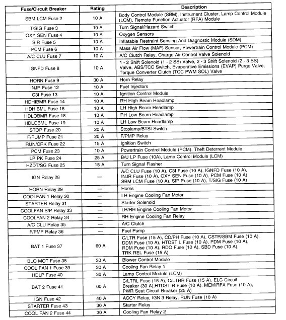

Taillights and instrument lights not working.
Dec 18, 2017 at 7:37 AM
  • 110,240 POSTS

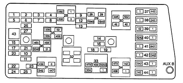

First, check to make sure the fuses are good. Under the hood is a fuse box. I have attached a pic of the box and what each fuse is for. If you look at the first one on the list, it indicates inst. panel lights and lamp control module. Check that one first.
