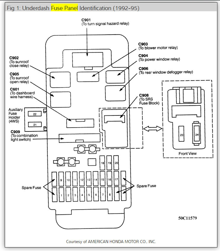

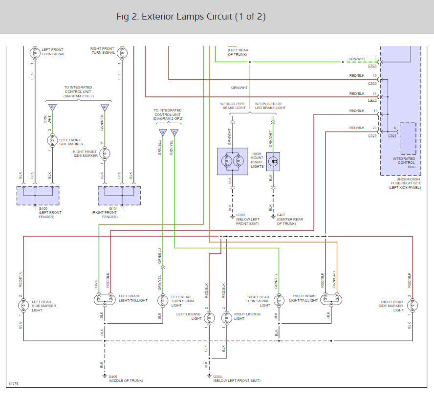

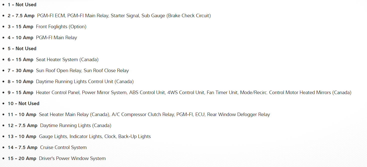

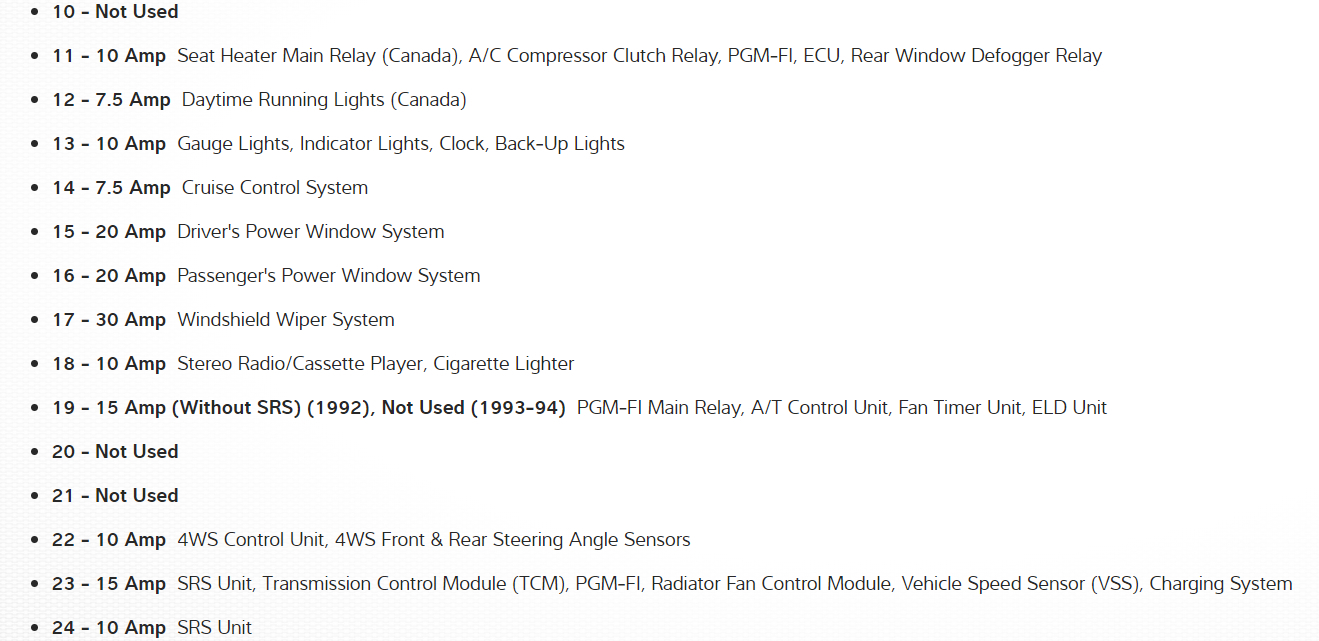

No taillights or dash lights. Help please, how and where do I fix it?
Jul 27, 2018 at 7:58 PM
  • 55,604 POSTS

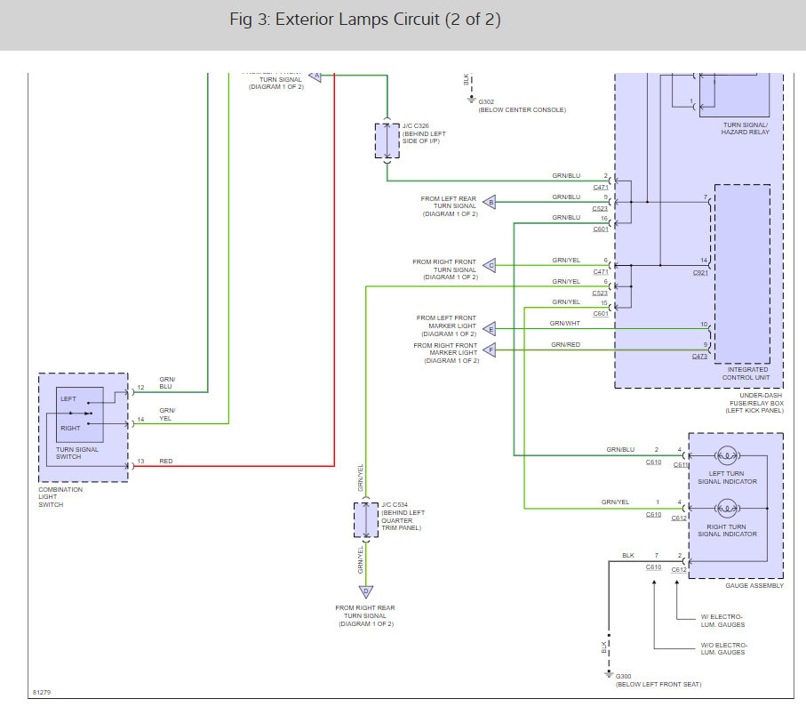

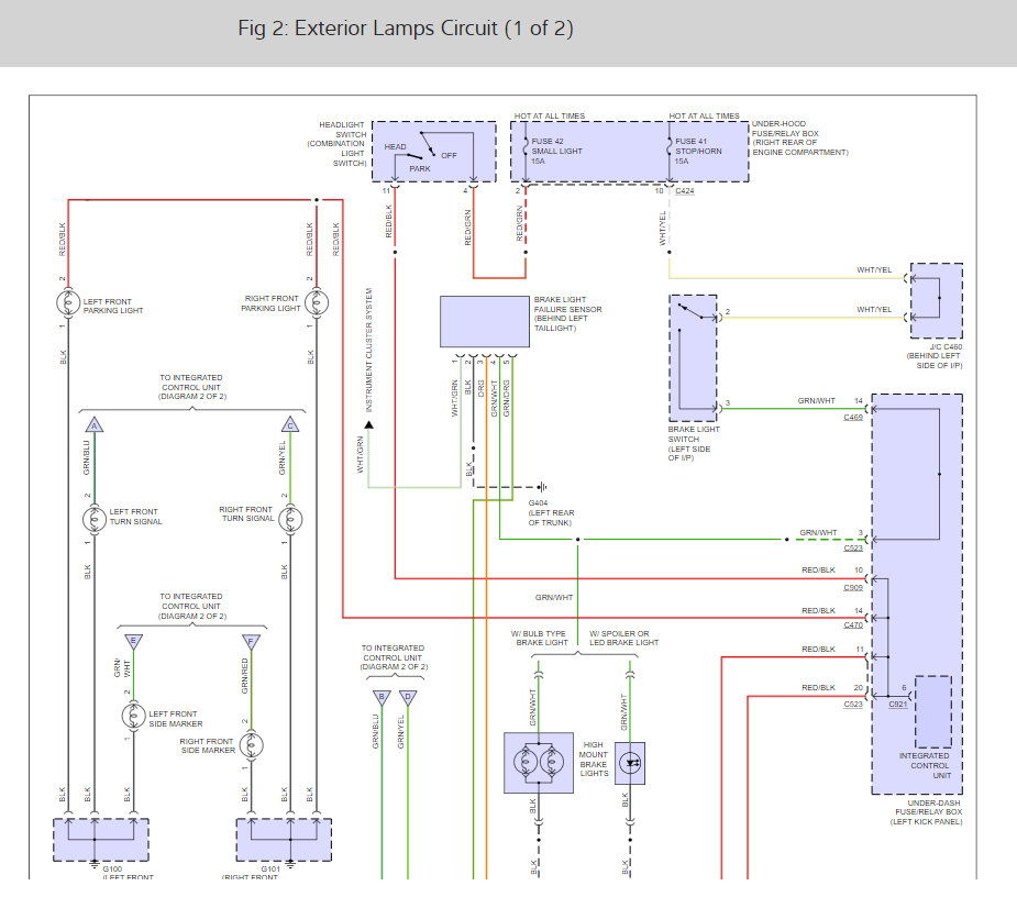

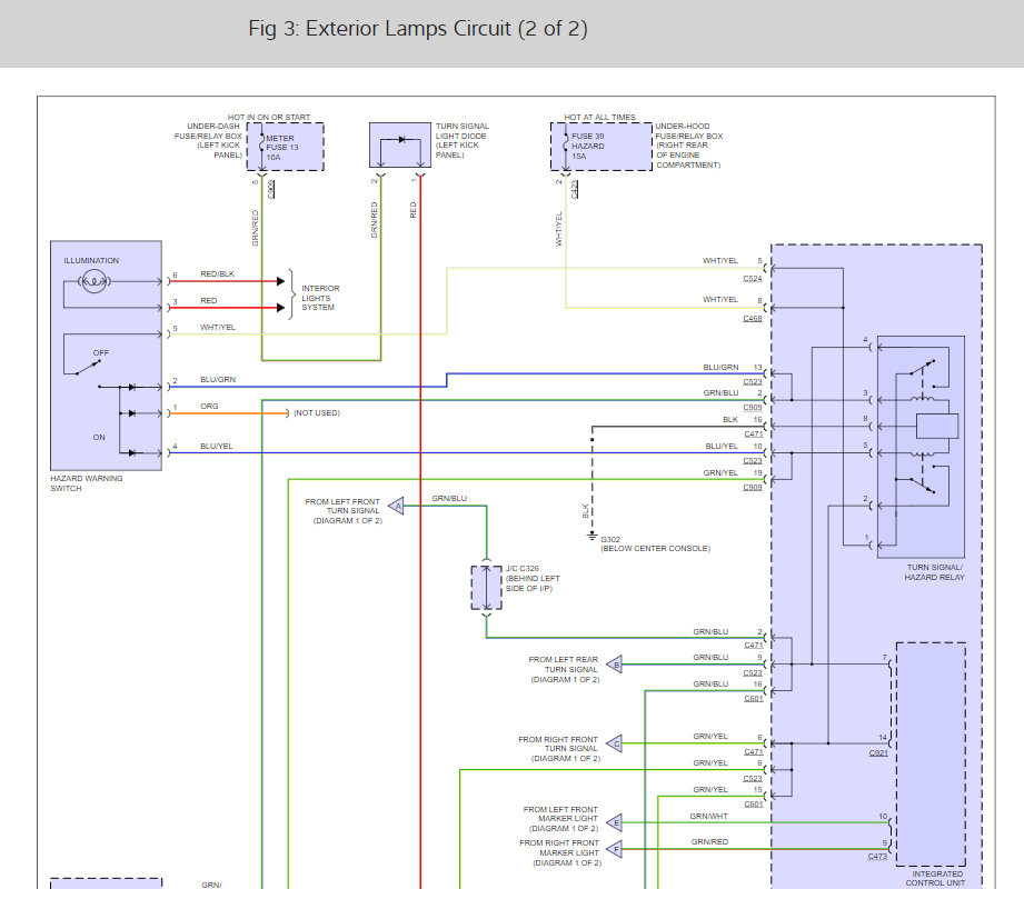

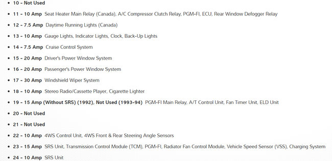

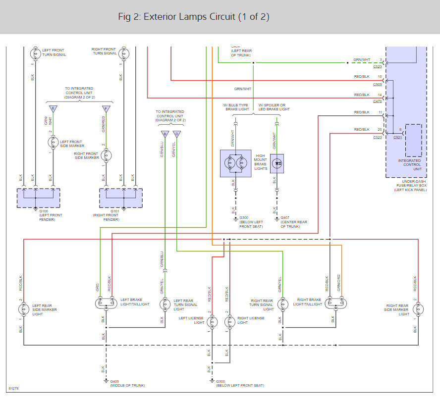

It sounds like you have a fuse out. Here is a guide to help you test to confirm the issue and the fuse location and the blinker wiring to see how the system works:
