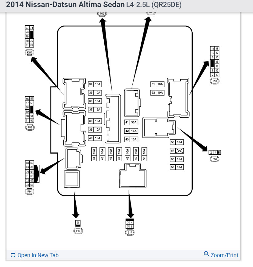

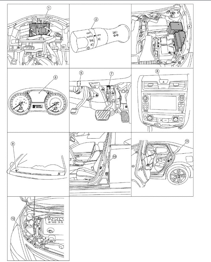

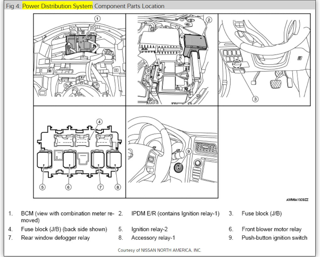

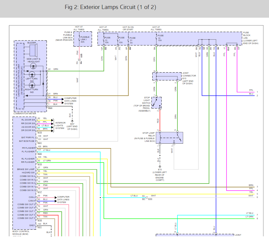

All lights work but my tail lights and dash lights do not work. The gauge lights works. Replaced bulbs connection is good and check all fuses.

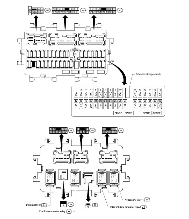

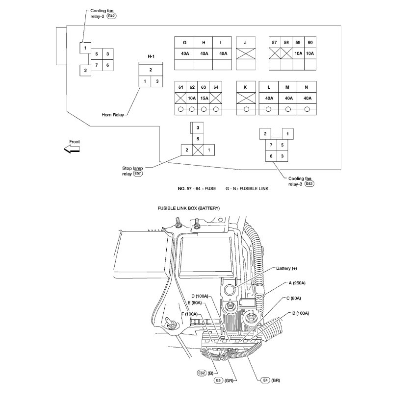

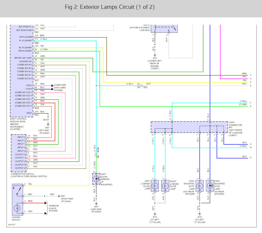

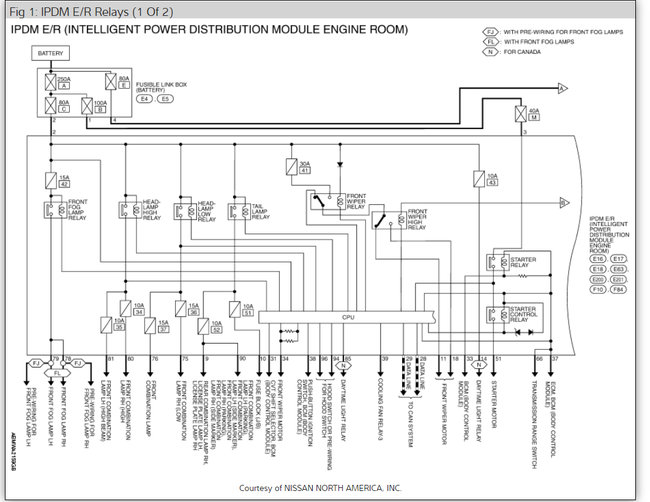

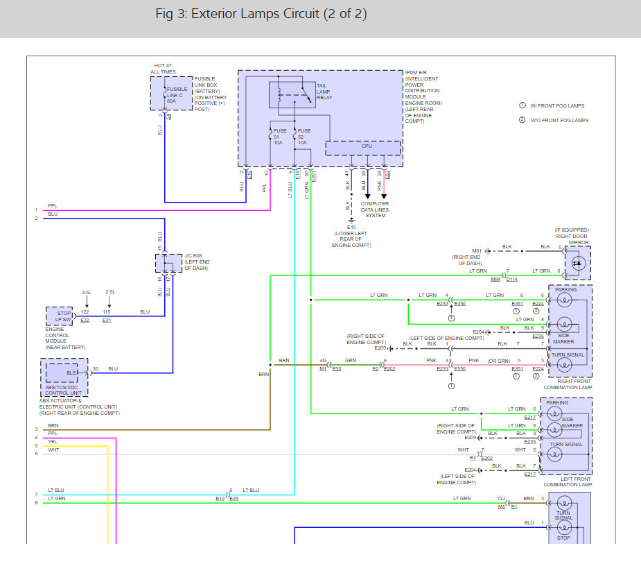

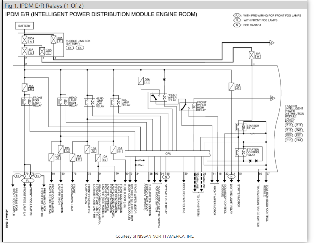

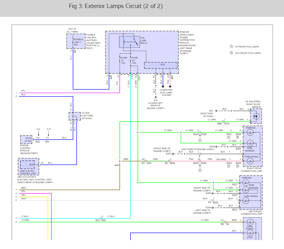

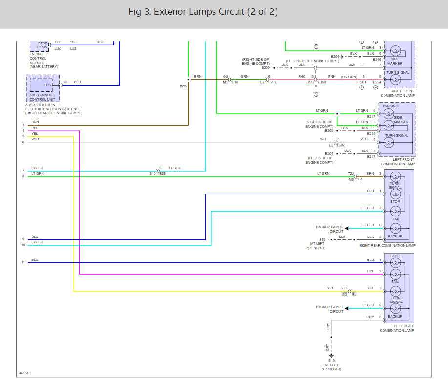

It sounds like you have a tail light relay that is not working. Lets use this guide to test the relay to confirm the issue. also there is fuse, relay and wiring diagrams for the tail lights so you can see how the system works.
