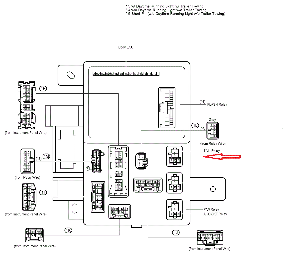

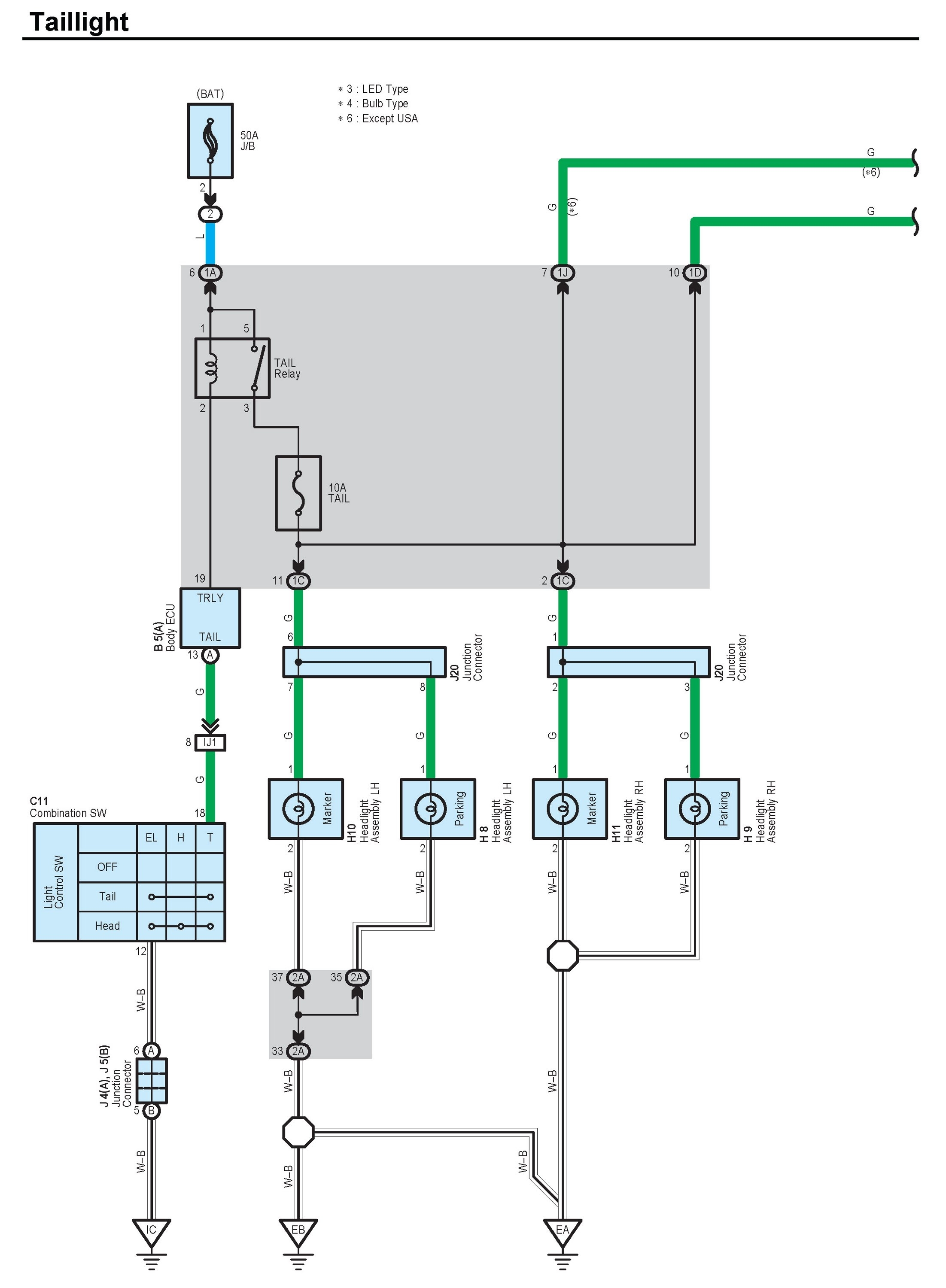

My parking/tail lights, and the license plate lights are not working. I have change fuses. Have a tail light relay to install, but there is no location on the fuse diagram.
Jun 1, 2017 at 7:55 AM
JIS001
  • 3,412 POSTS
It is in the body ECU see diagram and also check the 10 amp tail light fuse.
