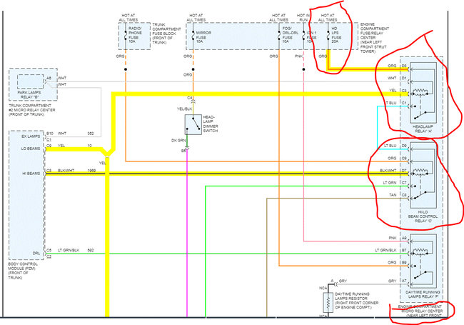

My tail lights and high beams are not working at all. My headlights will only come on in auto sensor mode and while in drive. Cannot turn on manually. Brake lights, parking lights, turn signals, and hazards are all working.

I need to confirm something. You indicated the tail lights aren't working first, and then indicate the parking and other rear lights are working. Please explain.
Next, I have attached a portion of the wiring schematic relating to the headlamps. First confirm the headlamp fuse itself is good and there is power to it.
If the fuse is good and there is power in and out of the fuse, then I need you to check the two relays I circled in the pic.
Here are a few links you may find helpful when testing:
__________________________
If everything checks good, then I suspect the switch is bad. However, let me know what you find before replacing it.
