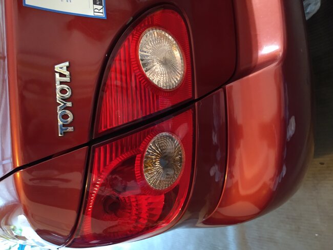

I noticed the taillights are not illuminated on both sides (brake lights do work)
Is it unusual to have both bulbs burn out at the same time?
I am wondering if this is something more than a bulb issue. how do I check fuses, relays, and bulbs (what is the process for diagnosing and fixing the problem?
Is there anything else I should be looking for?

I want to replace the taillight bulbs as my next step, all other lights and electrical are working. The light that is burnt out is the one that raises up with the trunk. The bulb in that area is the white one for the backup lights (it works). Is there another bulb in that area or is it reflected from the brake light assembly onto the taillight glass?
How do I replace the bulb that supplies light to the taillight?

The part listed in your diagram is all working, it is the part on the trunk (that has the white backup light) that is not illuminated. I am wondering if this is just a reflector only?
it is the portion under the Toyota emblem maybe this isn't meant to illuminate.
(Someone told my wife her taillight was out, but maybe this isn't the case then?)

Here's photos of your housings that I found on Rock Auto for the right rear. The first three are for the housing on the trunk lid, and they do indeed have just the back-up light. No tail light or brake light, so you're correct, the rest is just a reflector. The last two photos show the housing on the body. The last one shows the back side. There's two bulbs in it. One bulb has two wires, so it is a single-function bulb, most likely a tail light. The other one has three wires, so that one has two functions, meaning two bulbs built into one. That would typically be a combination brake / turn signal in one part and a tail light in the other, but be aware, for quite some time now the brake and signal functions have been split up to use two different bulbs. They did that to greatly reduce the complexity and cost of the turn signal switch, but it makes it miserable to hook up a trailer wiring harness.
Check to see if the various bulbs operate the same way on both sides. If they do, you're likely seeing normal operation. Because this system is very basic and common sense, a broken or corroded wire is going to affect just one bulb on just one rear corner, then you'd see a difference from side to side.
Let me know if all seems to be okay or if we need to look into this further.

I do believe this is just a reflector. Advanced auto also noticed on his car (Nissan) that the housing around backup light didn't illuminate...this is probably normal.
Thanks for the help and education!
