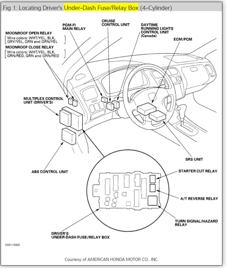

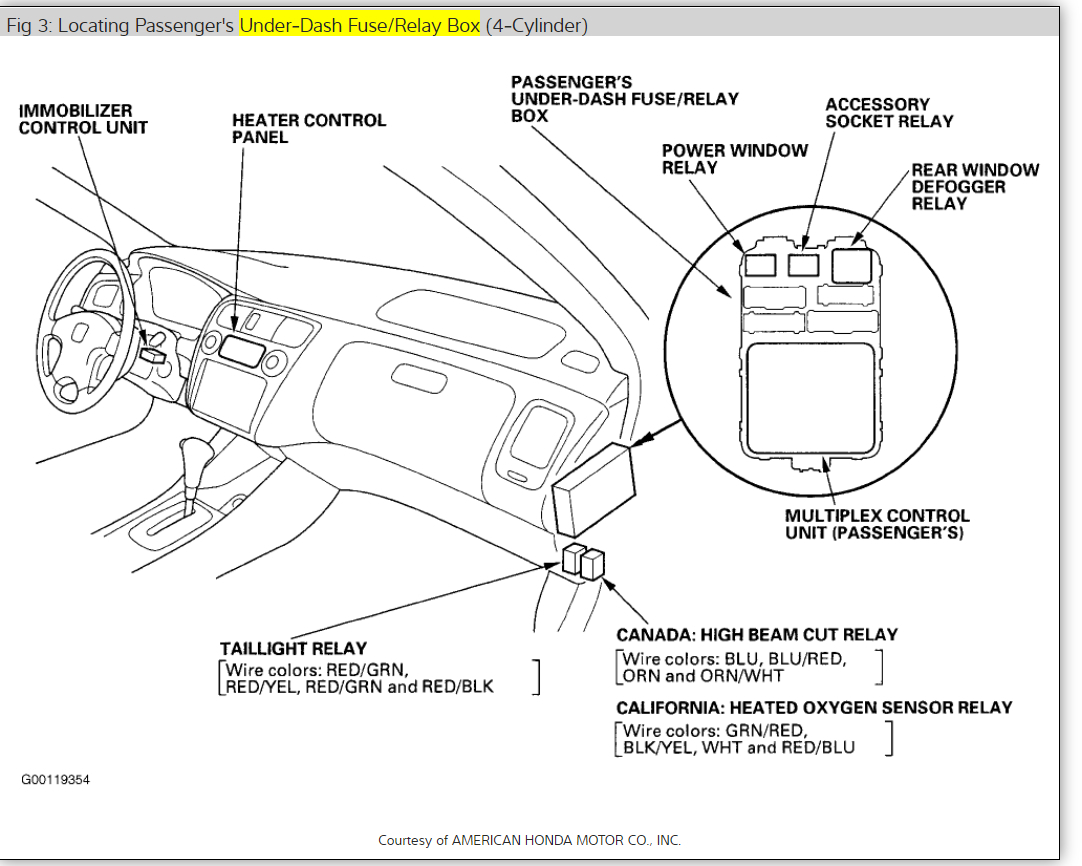

The headlights work fine. The dashlights, tail lights, license plate light are not working. The day before I bought the car it passed inspection so I’m not sure what changed. After I noticed the lights not working, the next morning the radio stopped working. It is a aftermarket radio.
May 5, 2019 at 12:22 AM
  • 55,743 POSTS

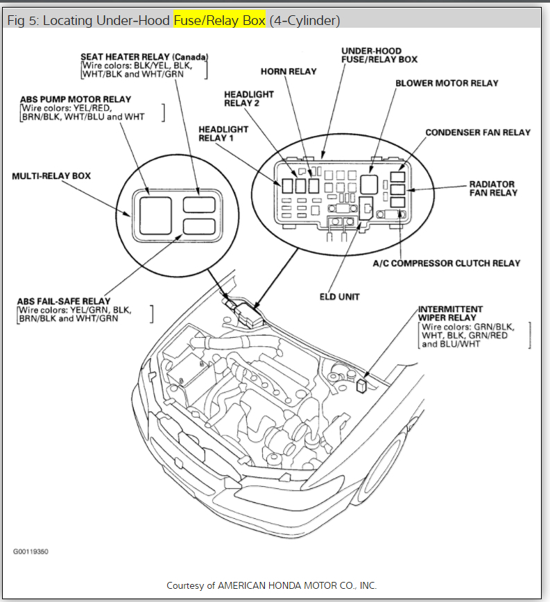

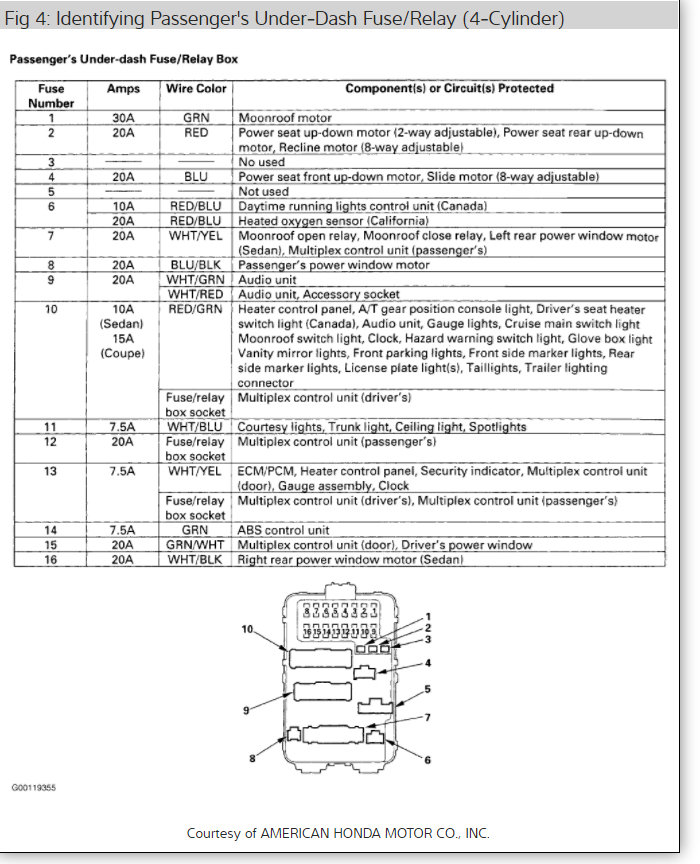

It sounds like fuse #10 has gone out in the passengers fuse panel but to be sure here is a guide to help you test for power and the fuse location as well
Check out the diagrams (Below). Please let us know what you find. We are interested to see what it is.
