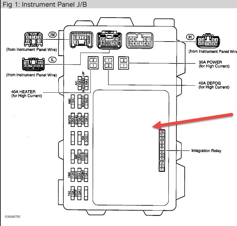

Please help. tail lights and console lights do not work. All other lights work. Fuses, bulbs and headlight switch checked. Car has a daytime running light system. Need to get tail lights to work. can you help?
Nov 6, 2016 at 12:20 AM
HMAC300
  • 48,601 POSTS

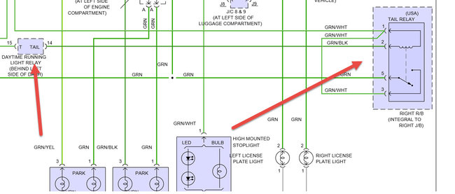

check the two relays in picture see if power goes in and out lights will need to be on to test.

if DRL module were bad a mechanic with a scanner would pick that up anyhow. your body module is called an integration relay it's on instrument panel junction block so check for loose wires or bad connections.

Well HMac300 was correct in saying check the relays. The problem was the tail light relay which is very hard to get to. Top of dash had to be taken off and vent on passenger side. Apparently this is a common problem in the toyota corolla according to the mechanic but its fixed yay!
