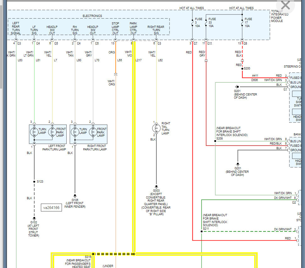

Tail lights do not work when I have my headlights on
2008 CHRYSLER PT CRUISER
167,786 MILES • 2.1L • 6 CYL • 2WD • AUTOMATIC
JANICE RATH
My brake lights work fine. Is there a fuse for my tail lights?
Jan 4, 2019 at 7:21 AM

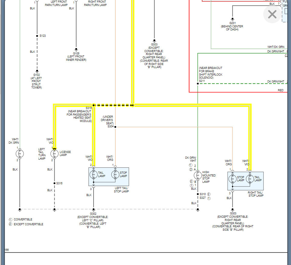

There is a a fuse for these lamps but it is also for the license plate lamp so if that is out as well then the fuse is the issue. Here is a guide that will help with this:
Also, here is a guide that will help with testing the voltage as that is what we need to do in order to figure out what the issue is:
Below is the wiring diagrams from the manual that will help with this in order to figure out what the possible issue is. However, I suspect you will find the fuse is the issue if the plate light is out as well.
