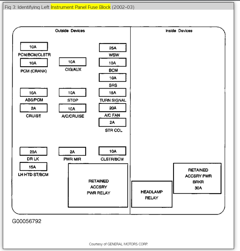

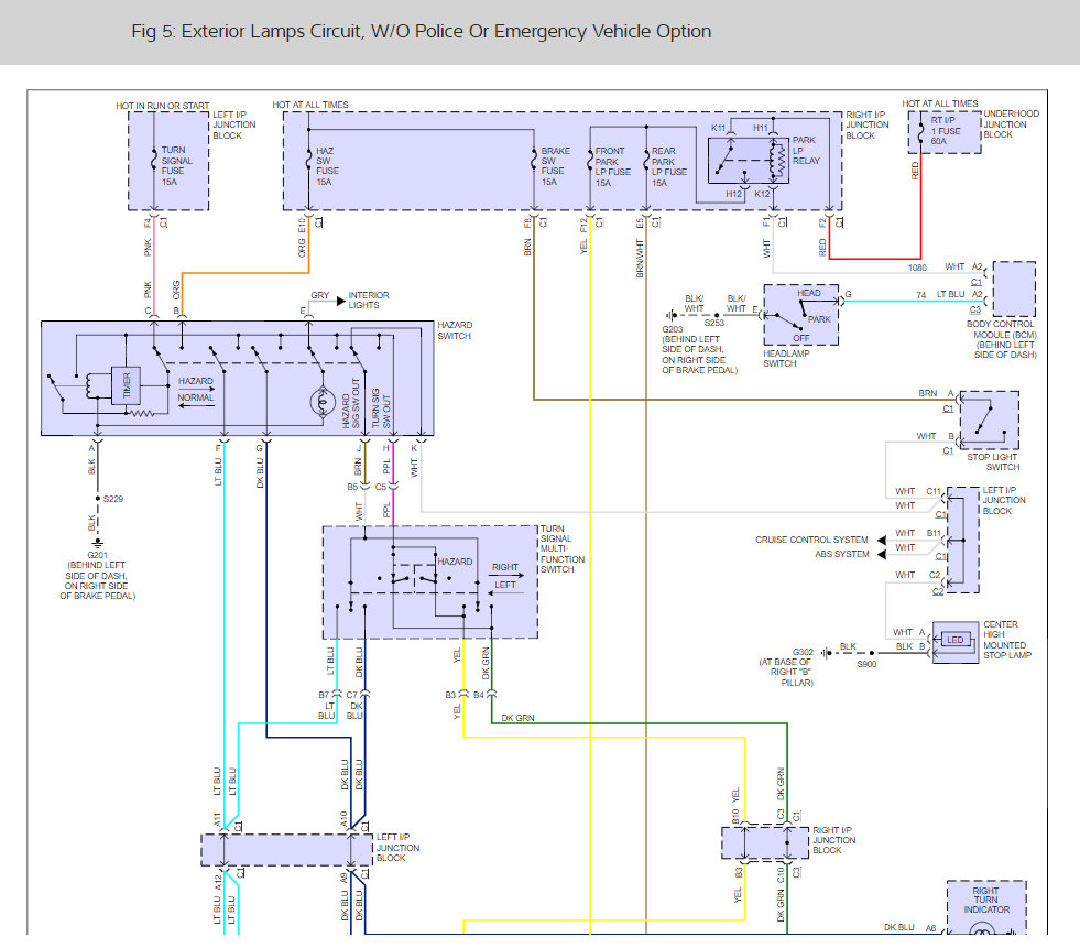

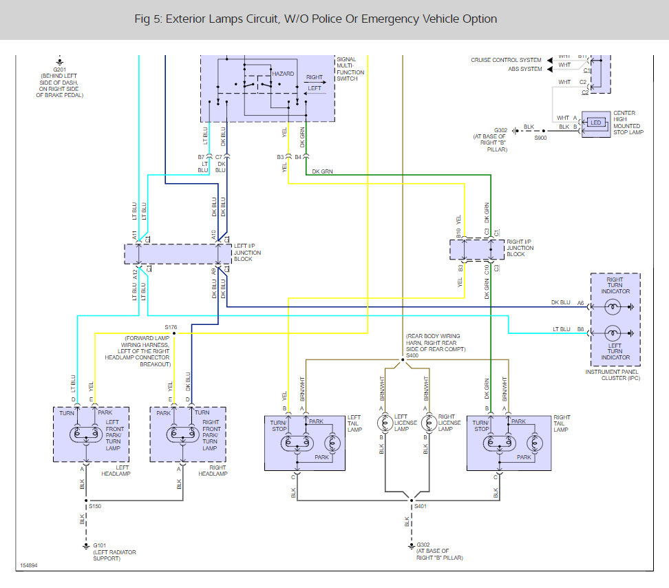

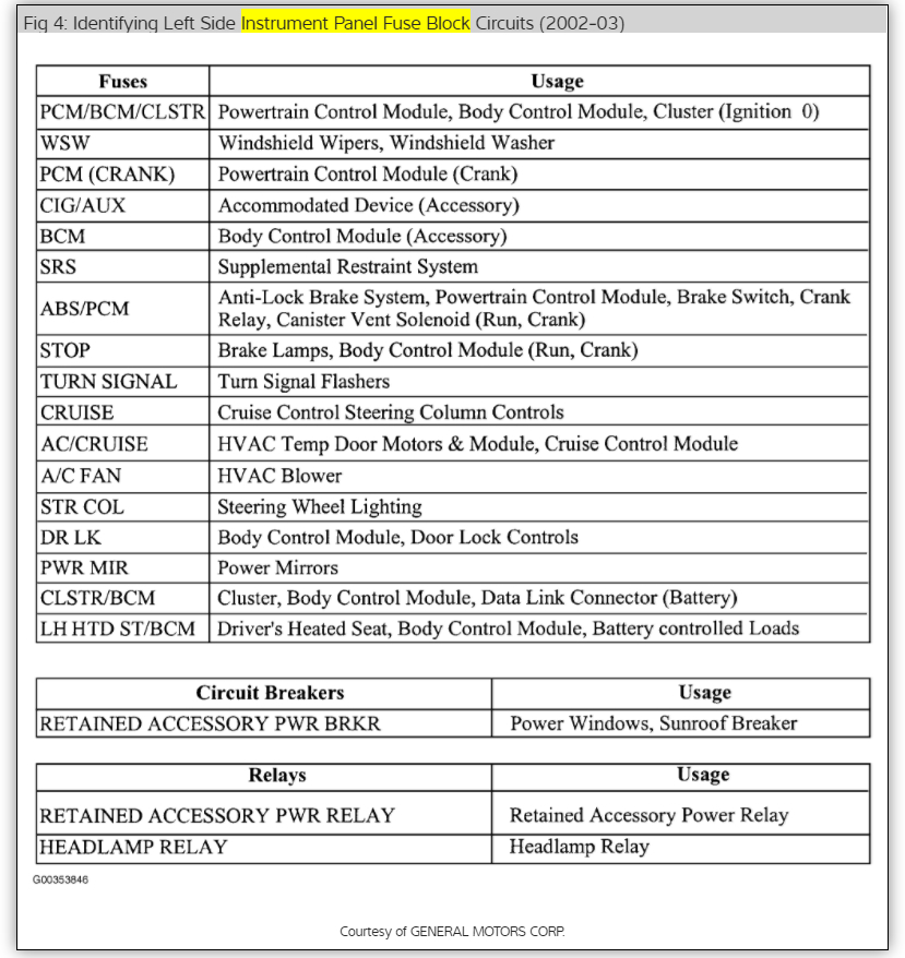

When I drive my tail lights do not come on at night. But my blinkers work. Do you think it is the actual bulb or do I need to replace the whole light?

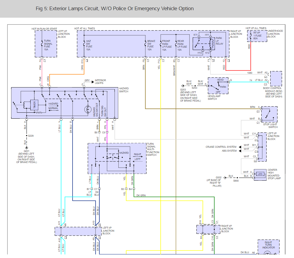

Check bulb first and check power and earth at the bulb holder as well. post back your findings for further assistance.

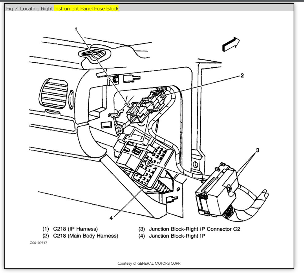

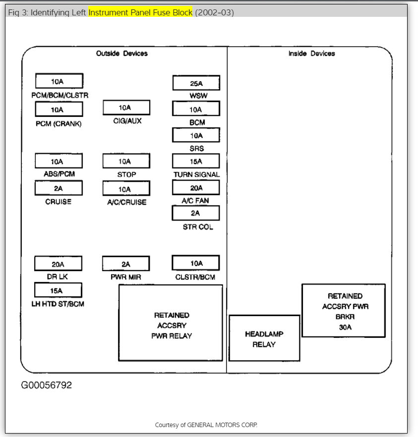

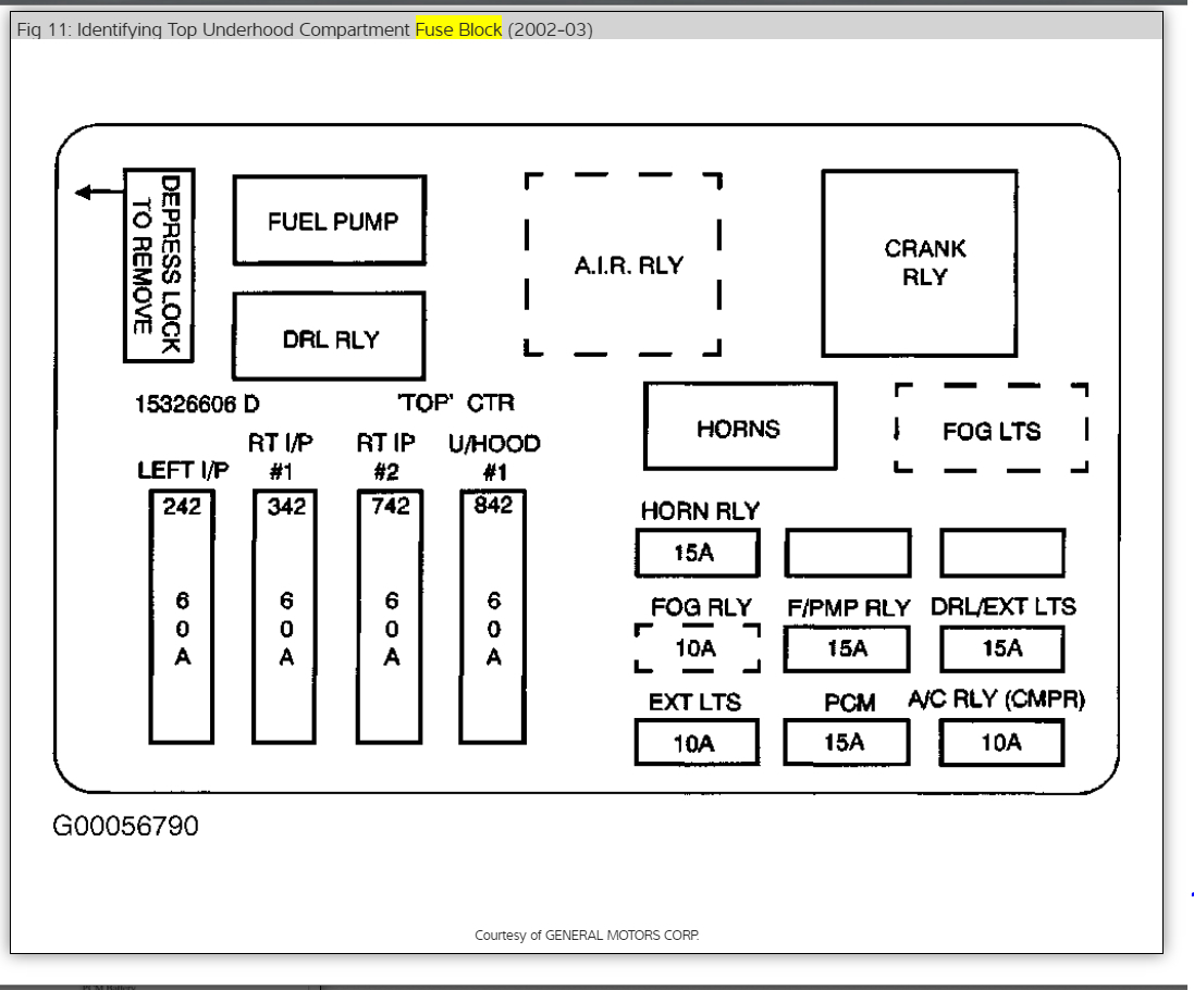

I replaced the tail light bulbs, but it is still does not come on when I drive. Can it be the fuse and where is the fuse exactly?

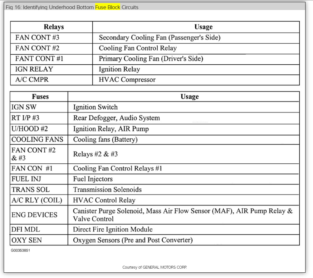

Here is guides and some wiring diagrams (below) to help you run some simple tests so you can get the problem fixed.
and
https://www.2carpros.com/articles/no-tail-lights-exterior-running-lights-tail-lights-out
