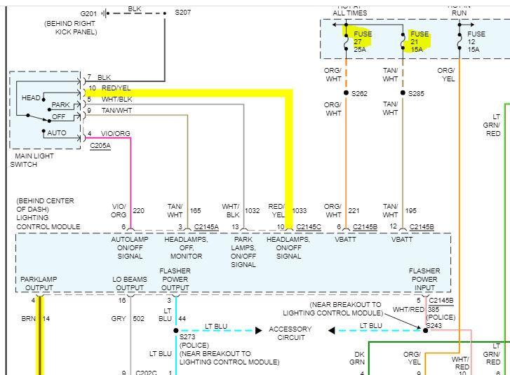

When I turn on my headlights my taillights do not go on. I check the fuse is good. I changed the headlight switch. All the bulbs are good. The LCM was change 3 years by the Ford dealer. What could be the problem?

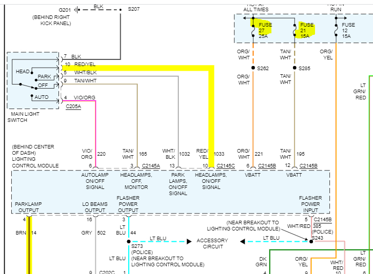

I attached a pic of the wiring schematic related to the exterior lighting. When the headlamp or parking lamp switch is turned on, the lighting control module (LCM) receives a signal which then powers the parking lamps. See pic below.
Here is what we need to check. At the LCM, there is a red wire with a yellow tracer. That wire should have power with the light switch on. We need to check that. If that has power, then locate a solid brown wire. That is the power out to the parking lamps. We need to see if there is power out at that wire. If there is power in and not out, the LCM is likely faulty.
Also, check fuses 21 and 27 in the central junction box under the dash are good and have power to them.
Let me know what you find.
See pic below.

Hi, I check there is power on both sides in and out. The LCM was recall for the headlights 3 years ago. Should I take it back to the Ford dealer?
Aug 9, 2023 at 7:36 AM
  • 110,240 POSTS
Yes, if there was a recall, it sounds like the same problem has returned. Contact them and ask first to see what they tell you.
