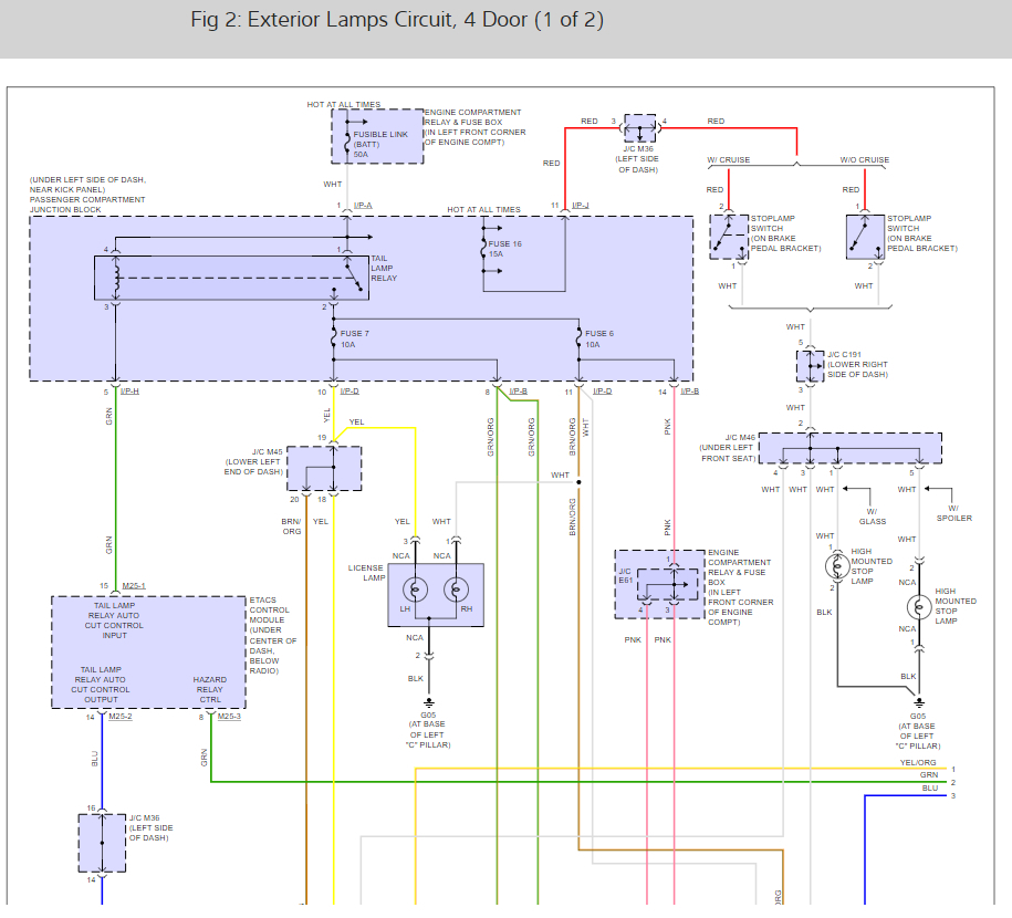

When I shut my car off tonight the tail lights stayed on. The headlights are off, there are no warning lights or any other problem. I restarted and turned off the car and lights a few times, they are still on after four hours.

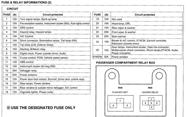

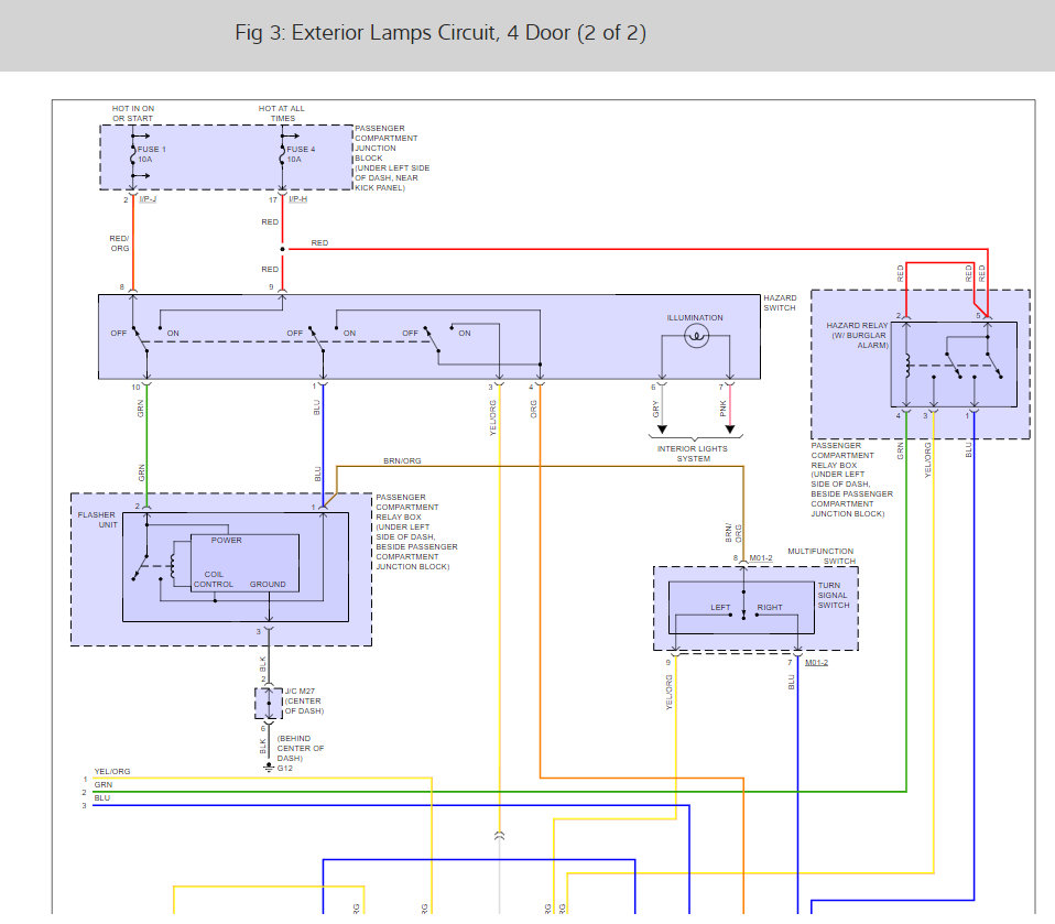

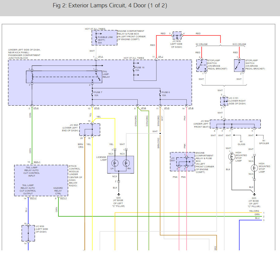

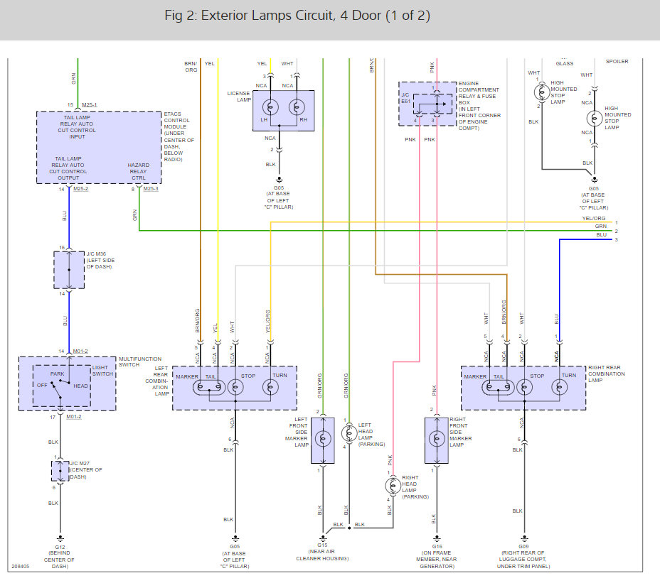

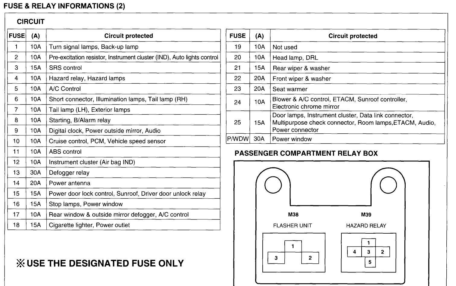

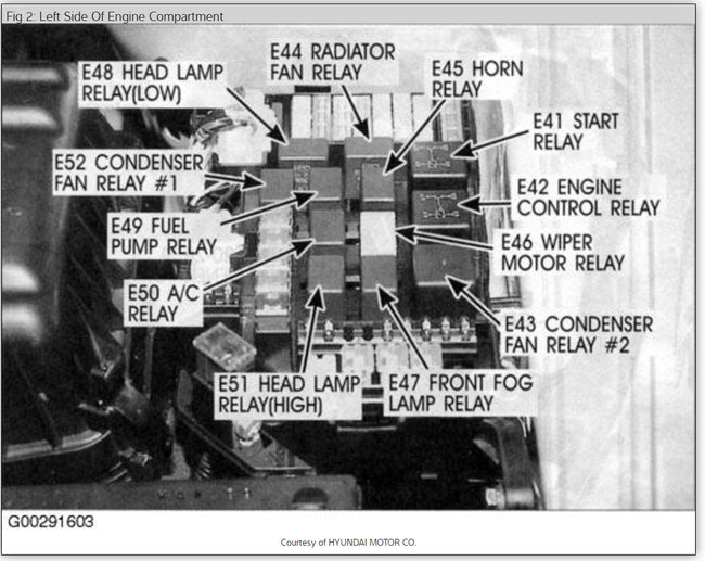

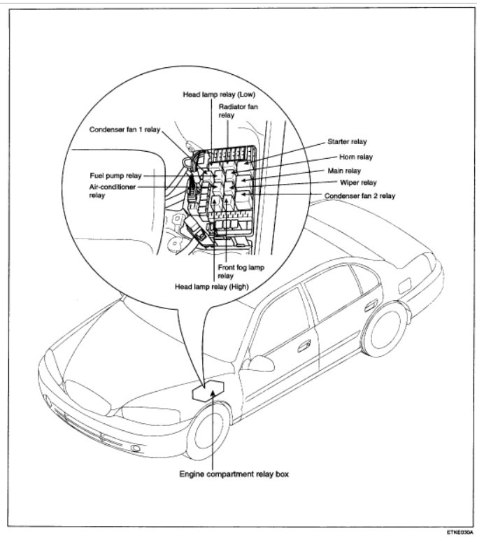

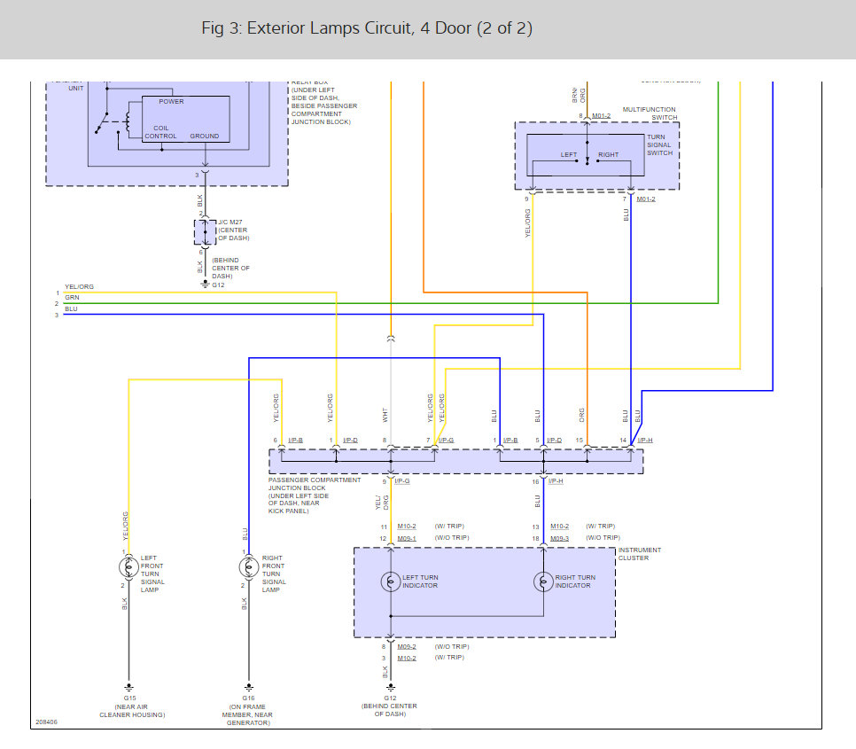

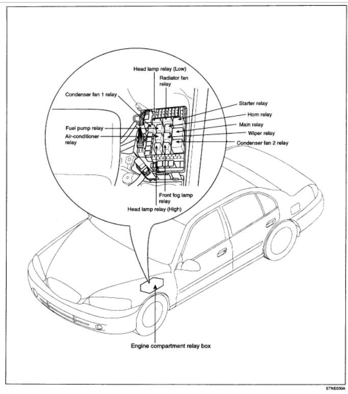

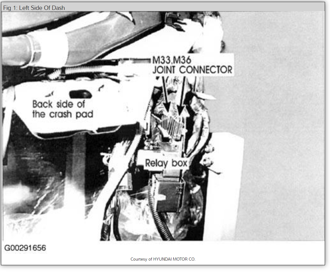

You have a tail light relay that is stuck on and needs to be replaced. Here is a wiring diagram for the running lights so you can see how the system works and a guide to help you test the relay once you find it from the diagrams below.

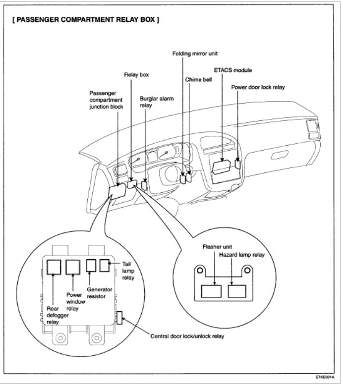

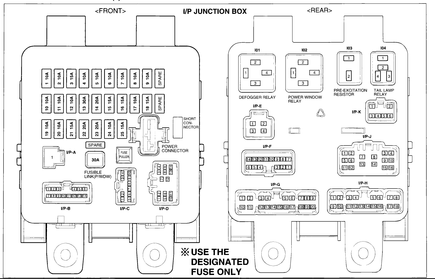

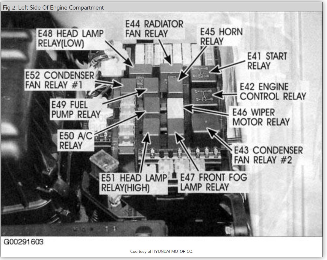

The relay is under the dash on the drivers side here are fuse and relay locations so you can see where to find it. I would save this page in your favorites for future reference.\
