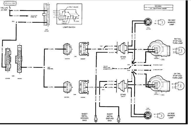

My tail and dash lights keep going out. changed fuse one time it worked, did it again changed fuse it did not work.
Jan 28, 2018 at 3:28 AM
  • 55,423 POSTS

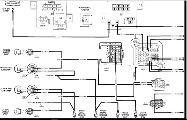

You must be loosing power somewhere are have a shorted wire lets run this test to see whats going on. It sounds like you have a headlight switch that may have gone out.
Below are the wiring diagrams for the running lights.

Thank you I will try that. I have priced the switch if that is what it is.
