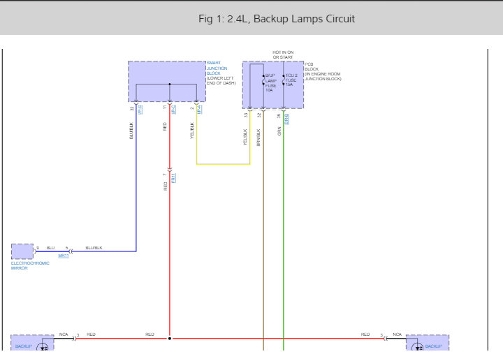

Can I get the taillights wiring diagram?
60,000 MILES
POORJOHNN

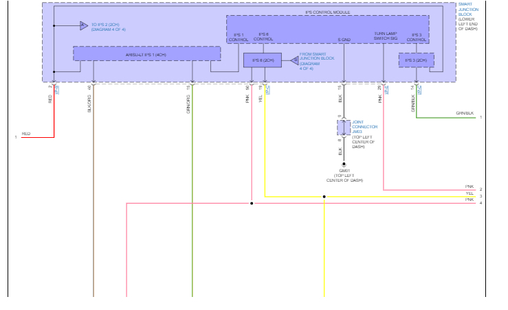

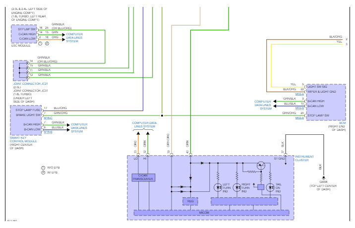

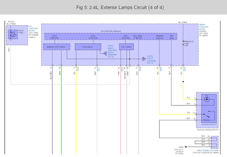

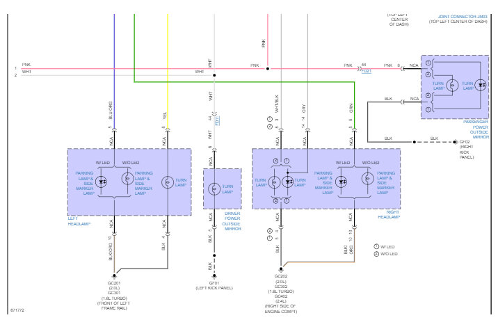

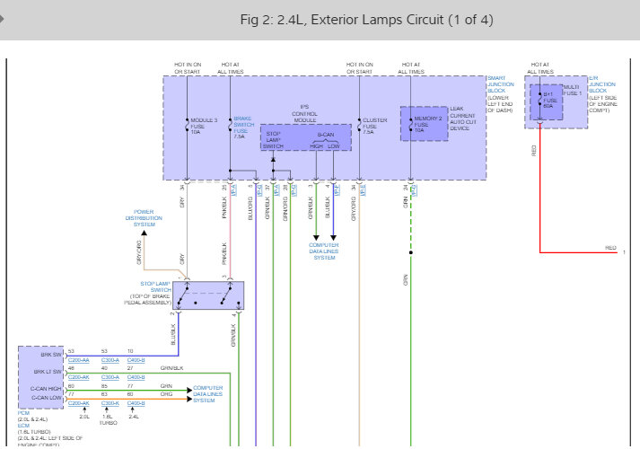

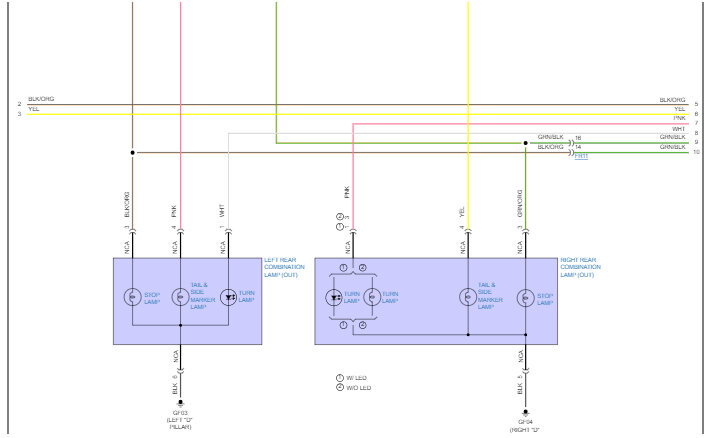

needing diagram to wire lights to small trailer.
Sep 14, 2023 at 10:04 PM
  • 110,251 POSTS

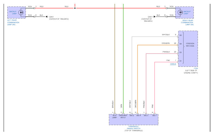

If you look below, I attached the exterior lighting schematics. They were four pages long, but I had to cut them in half to make them readable for you.
I did overlap them so you can follow. Additionally, at the start of each new page, I added what circuit the schematic is for.
