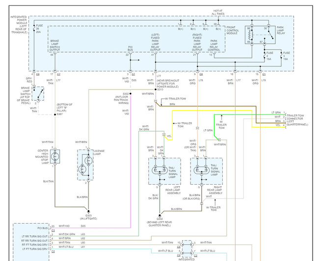

No nighttime rear taillights. 2-Fuse, bulbs, sockets check good. All other light work.

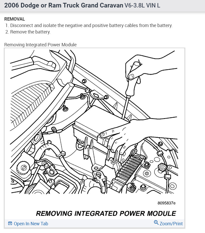

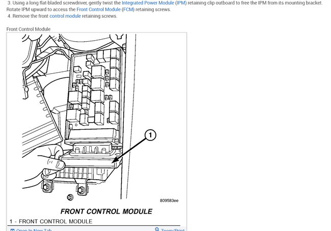

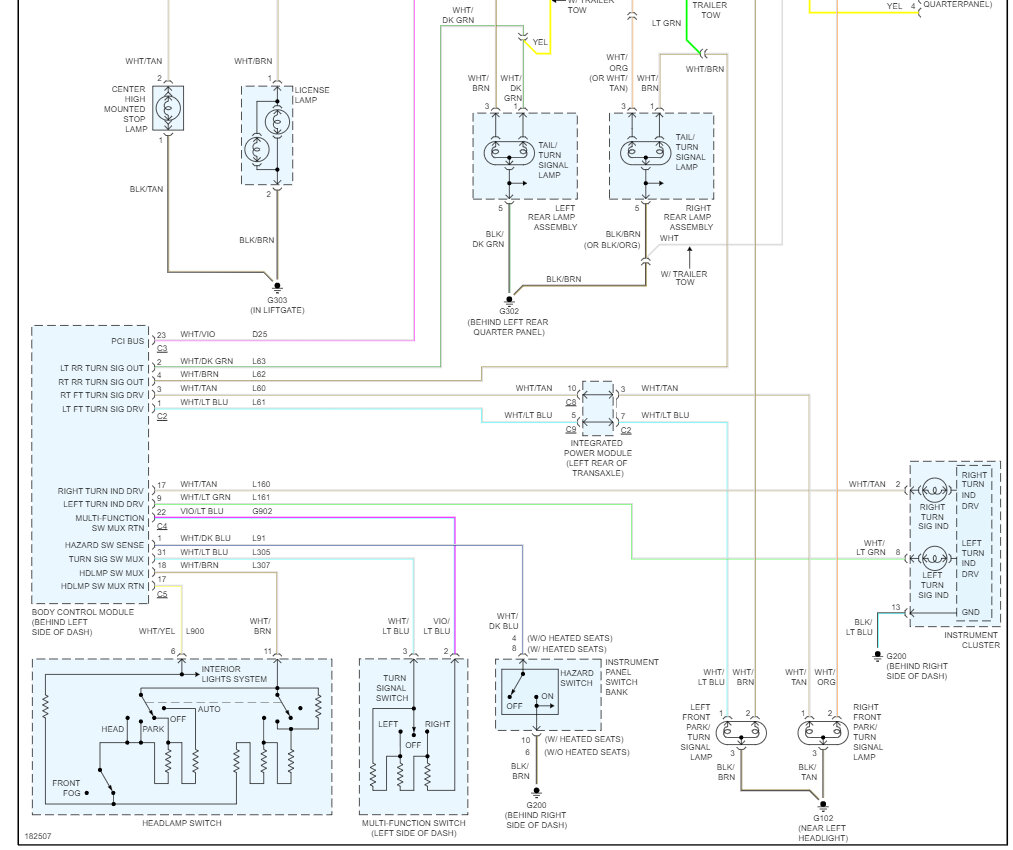

I have seen the TIPM go out which causes the running lights to stop working. Here are the running light wiring diagrams so you can see how the system works and I have included how to change the TIPM out which is easy because it-self learns. Check out the images (below). Please let us know what you find.

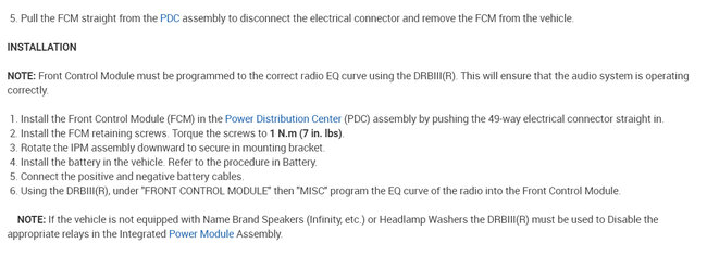

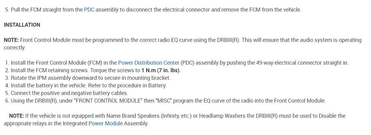

Thank you, I will give all this a try this weekend. I'm not sure how to program the radio as mentioned in your #6 installation FCM. Any help there?
Thanks again.
Mar 6, 2023 at 5:05 AM
  • 55,616 POSTS
Yes, the DRB111 is a factory scan tool that is used to preset the radio equalizer. I would not worry about that right now. Let me know wat happens.
