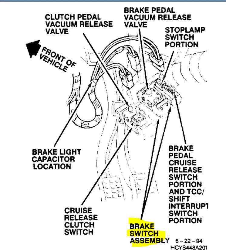

Tail lights stays on after I turn my car off

It drained my battery while I went for a quick shopping trip.

Is it the parking lights or the brake lights? If the brake lights, locate the brake light switch at the top of the brake pedal. Confirm it is properly attached and the plunger is fully moving when applying the brakes and returning when brakes are released.
Next, if it is the parking lights, let me know. We will need to start checking wiring for a short to power.
Pic 1 below shows the brake light switch location.
See pic below.
