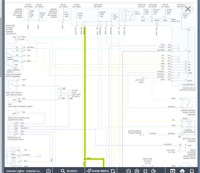

Taillights, running lights, license plate lights not working. Bulbs good, fuses good. No clicking relay sound anywhere when I turn lights on. I don't know where that relay is.
Mar 31, 2022 at 4:38 AM

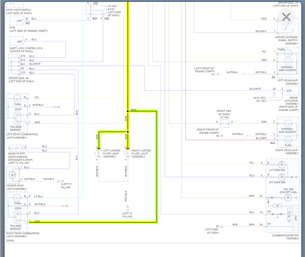

Sounds like you are on the right path. The relay for this is in the driver side junction block. They also run off the tail fuse also so this should be checked as well.
I am attaching the wiring diagram below for this. I would suggest starting with the license plate bulbs as this is a simple circuit and would be the best to start with because if you figure this one out then the others will most likely be fixed as well.
Please run through this info and let me know what questions you have on this one.
Thanks
Apr 1, 2022 at 5:01 AM
POHEARN
Thanks very much Kenney, that really helps a lot! In the end it was a fuse problem. The fuse schematics in the owner's manual didn't match the box. I reworked many combinations methodically and got lucky. Thanks so much. You're wiring diagram really helped my thinking!!
