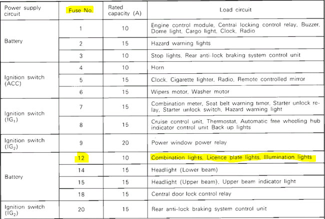

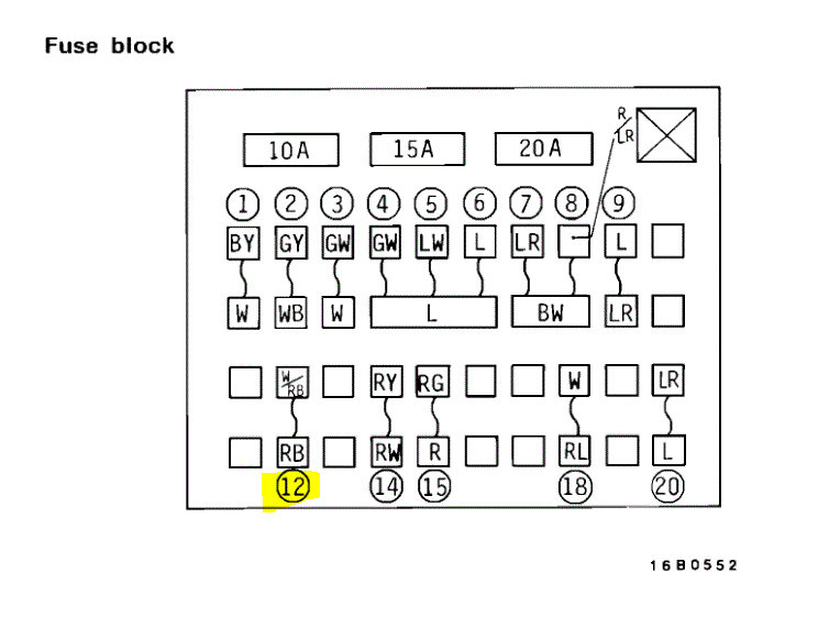

Need to know where the tail light relay if it does and location to include the fuse box diagram.
Jun 17, 2021 at 5:05 PM
  • 110,194 POSTS
Good to hear from you. Listen, I looked everywhere for a tail light relay and nothing shows. The only relay I can find is for the fuel injection. That is the only thing identified as a relay.
Also, I found the fuse for the rear lights and a pic of the fuse box. However, it is vague. I did highlight the location.
