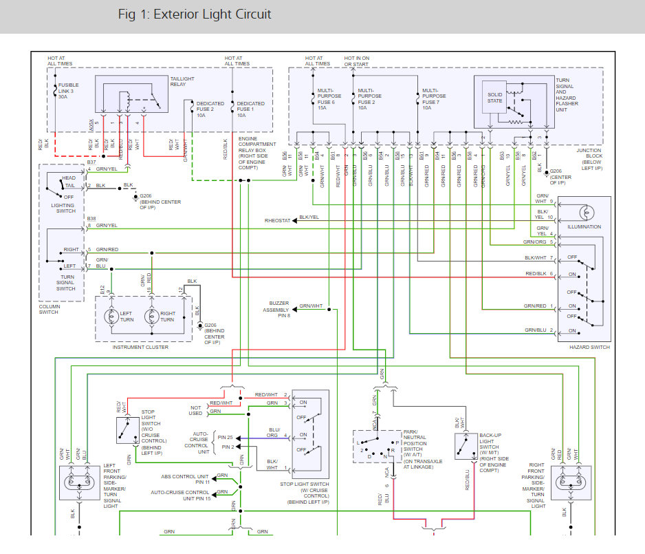

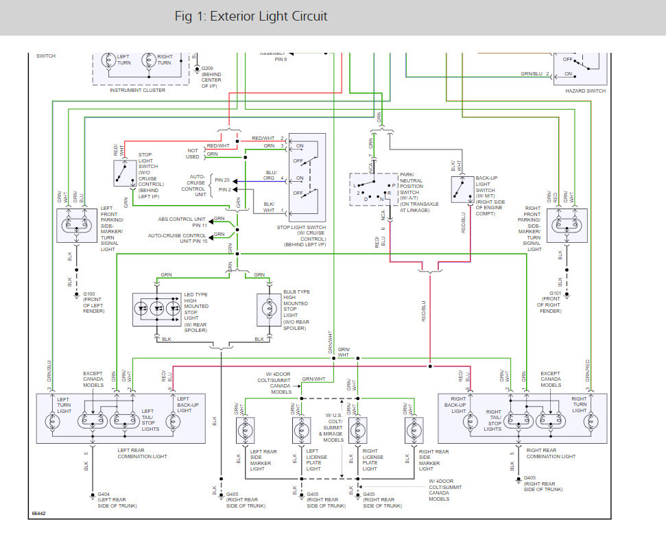

No taillights brake lights or running lights, need relay location
233,000 MILES
APRIL SPARKS
Bulbs are good fuses good. can't find relay to test?
Dec 7, 2019 at 11:08 PM
  • 55,710 POSTS
It looks like everything runs through the hazard switch. can you please cycle it back of forth many times to clean the contracts to see if the system works? Here is a guide to help you test for power and the blinker and brake light wiring diagrams to help you see how the system works and which wires to test for power:
