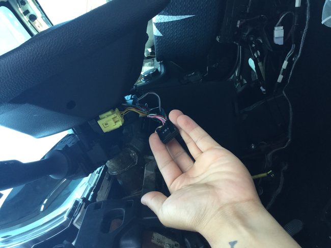

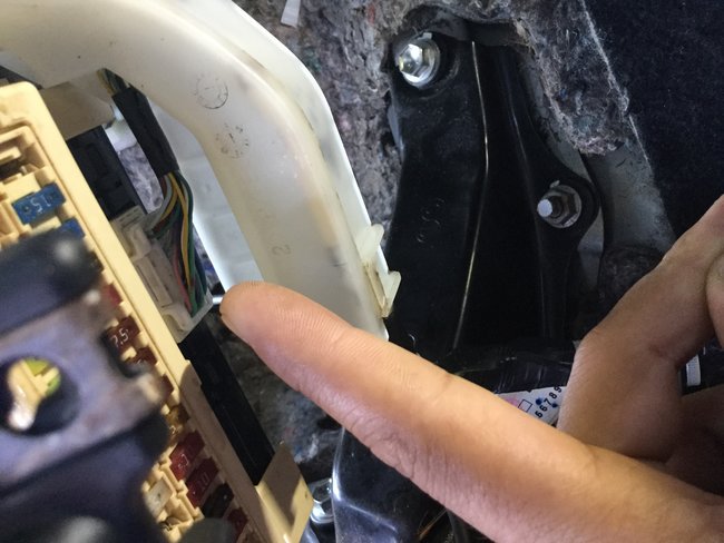

In that video I founded wire to turn tail light and I checked it. The input from positive white wire on junction block. And the other side my test lamp I attached on the headlight switch and near to ECU. (Pic 1, 2) the wire is okay.
Mar 23, 2020 at 12:43 AM
Okay. So if the switch is working then I suspect the main body ECU is the issue which is part of the junction block. I would just turn the switch on and then check voltage coming out of the junction block that I highlighted. If you have voltage there then go to the lamp and check for voltage. If no voltage there then you have a wiring issue.

Hi KASEKENNY, I checked tail fuse with my test lamp, and voltage coming out the junction block but no voltage there are. My issue is ECU Think I.
