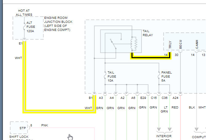

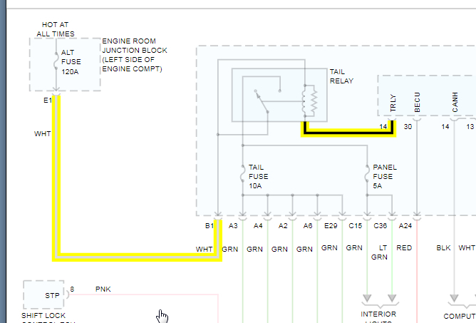

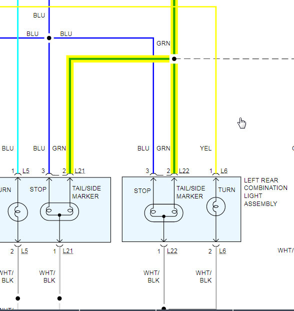

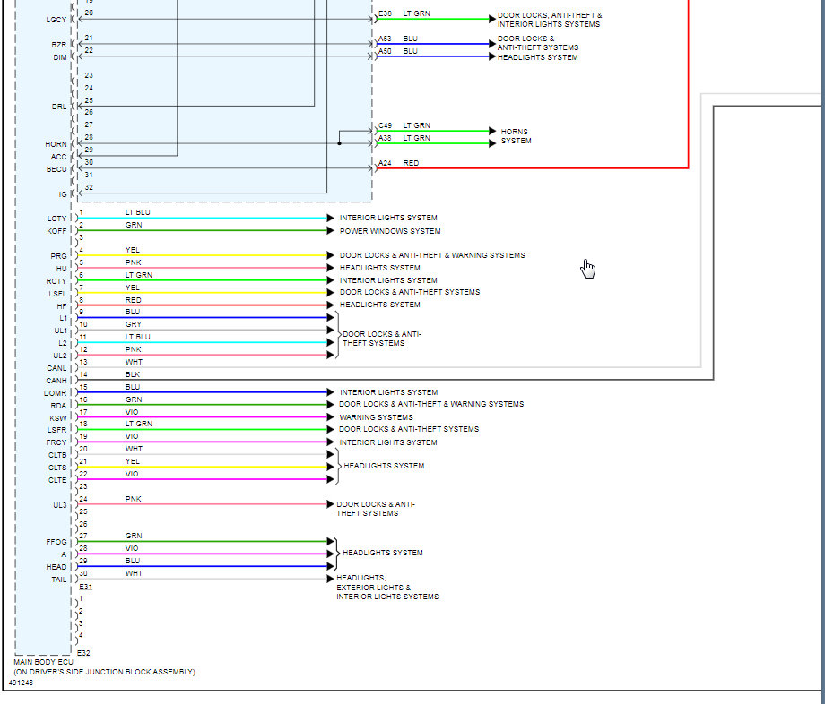

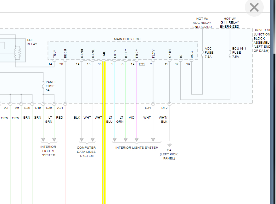

This is most likely one of two issues. Clearly when pressing the brakes it shows the lights work so that means we most likely have a control issue. That means the switch itself is not signaling the BCM in the junction block that the lights are on (unless the head lights come on normally). Or the Body ECU is the issue. So we need to test two things. First if you have voltage going into the junction block on this circuit and second if the relay for the tail lamps is okay. It is not clear if this relay is used only for tail lamps or brake lamps as well so we need to check it and make sure.
Take a look at the diagrams and we can go from there.
Mar 22, 2020 at 8:24 AM
Actually I take that back. This relay appears to work for the headlights as well. So do the headlamps work normally?

I follow your instruction step by step. I can’t find the relay on the last picture . Please help me.

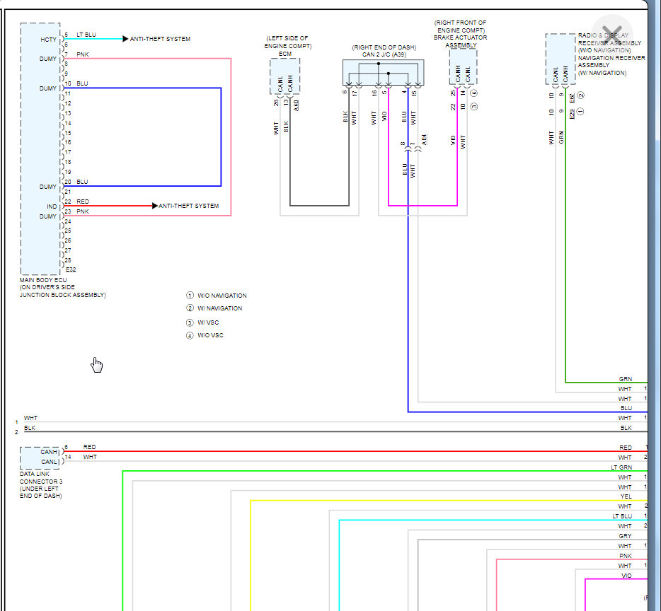

Okay. I can't explain what happened but the body control module controls each one of these items.

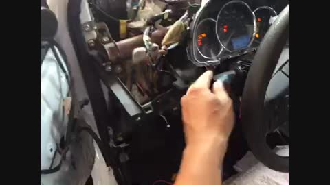

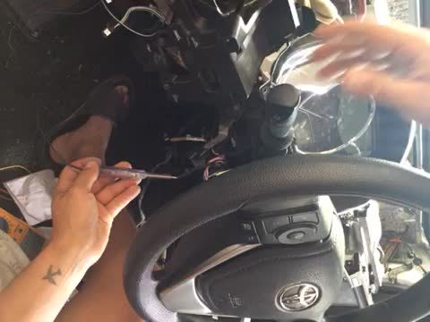

When you were testing the switch in that video, were you on the input from the switch to the BCM or was that the output control from the BCM meaning the BCM was sending the lighting command for the tail lights?

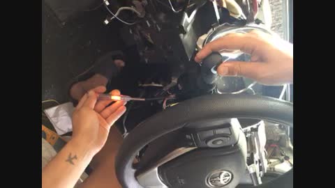

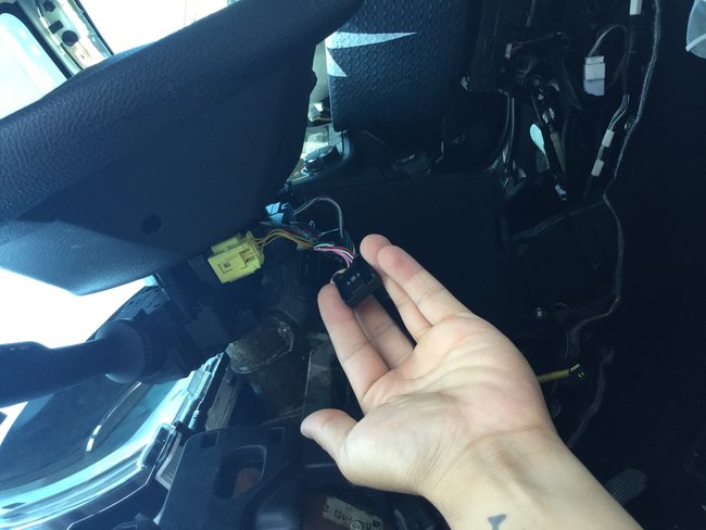

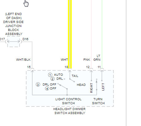

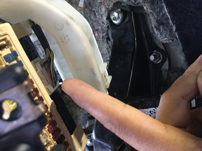

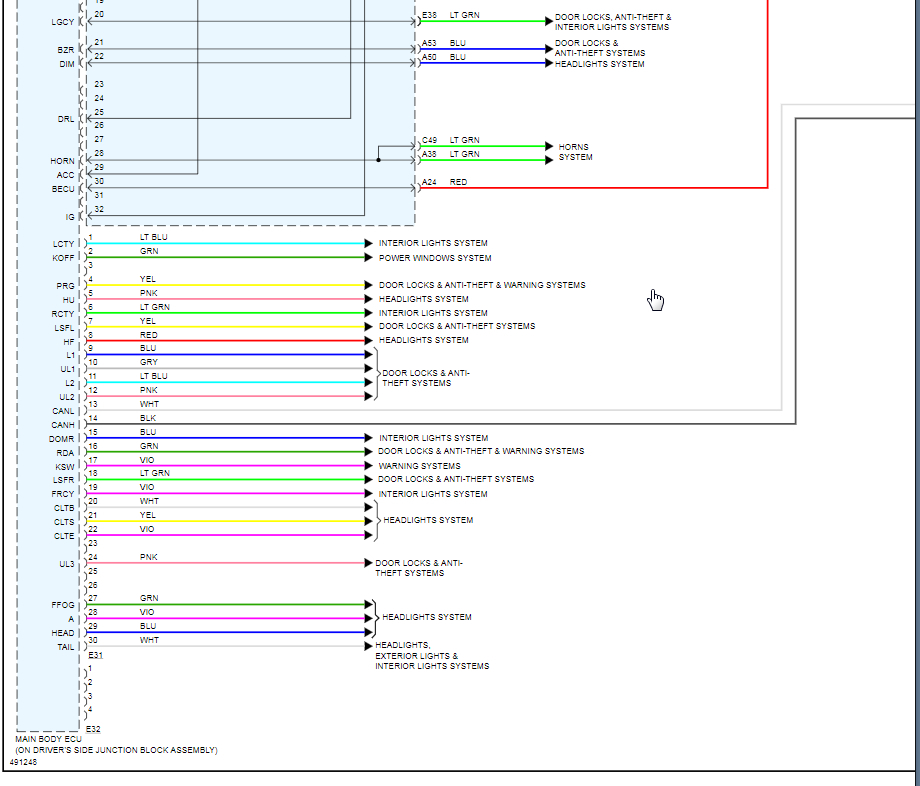

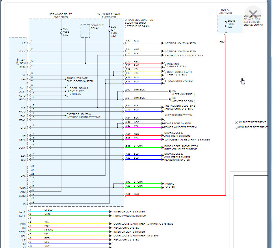

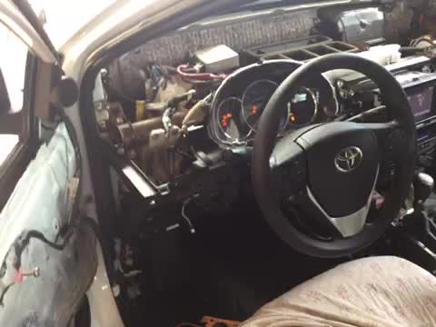

In that video I founded wire to turn tail light and I checked it. The input from positive white wire on junction block. And the other side my test lamp I attached on the headlight switch and near to ECU. (Pic 1, 2) the wire is okay.
Mar 23, 2020 at 7:43 AM

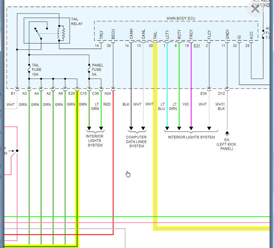

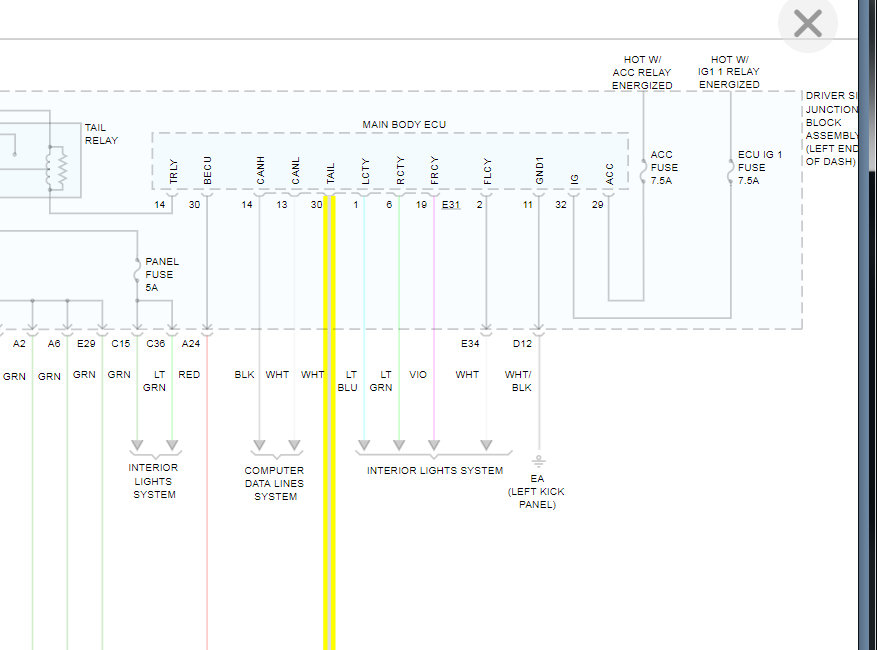

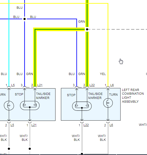

Okay. So if the switch is working then I suspect the main body ECU is the issue which is part of the junction block. I would just turn the switch on and then check voltage coming out of the junction block that I highlighted. If you have voltage there then go to the lamp and check for voltage. If no voltage there then you have a wiring issue.
Mar 23, 2020 at 9:10 AM
CTORRES
  • 67 POSTS
Hi KASEKENNY, I checked tail fuse with my test lamp, and voltage coming out the junction block but no voltage there are. My issue is ECU Think I.
I was checking eBay some of them but I have a question for you.
1) If i buy a ECU I need to reprogramming?
2) buy a ECU with junction block?
Thanks for your patience, experience, time etc. All your tips and wiring diagram were amazing.
Take care.
CTORRES
Mar 24, 2020 at 1:14 PM

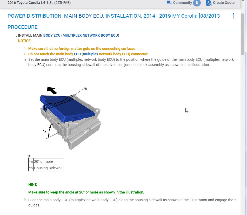

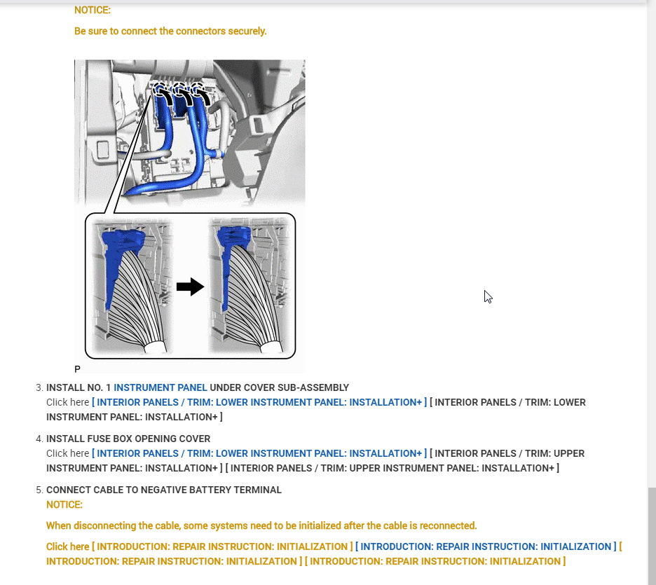

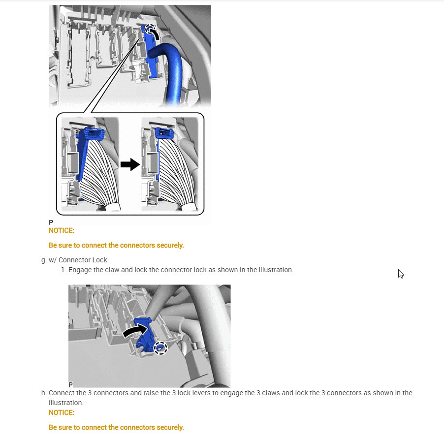

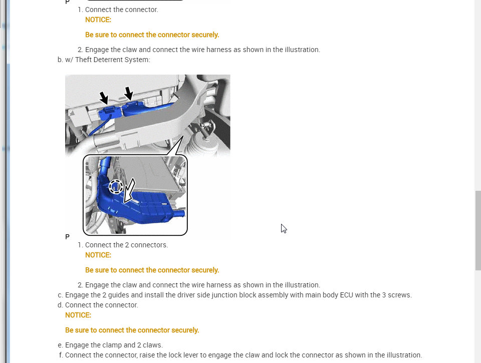

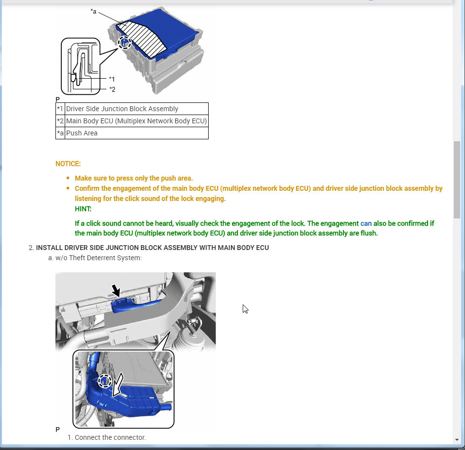

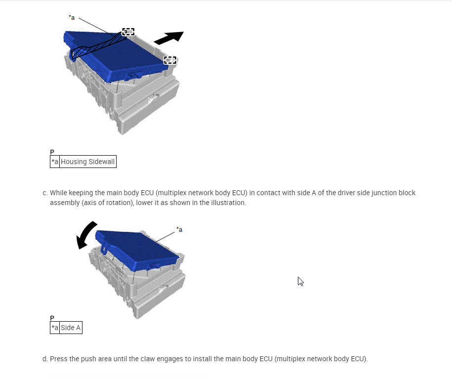

I agree that it appears this is what is needed. However, I don't think you need the junction block as well. I would just go off of price. If it is not much more then I would just get it. I attached the process to replace just the ECU. It doesn't mention needing to be programmed so I am assuming it does not. I have not actually replaced one of these personally so I am relying on the manual that would tell you to program it if needed.

Kasekenny. Hello,it is me again. finally the Junction Block and ECU are in Panama. I removed and performed operational test but does not have taillights. I’ll check all and text to you.

Hello. Well I have good news all lights are working. Thanks KASEKENNY and 2CarPros I appreciate your time, experience, all tips and all information about my car.
