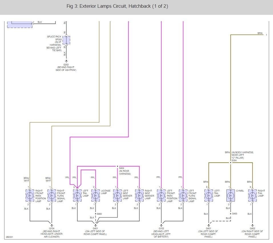

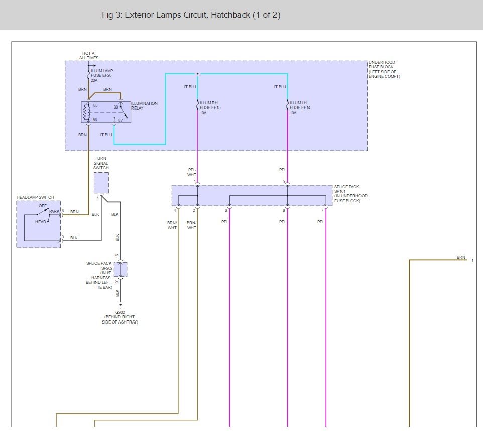

my driver side tail light the running lights are off. I changed socket bulbs fuses nothing works. it works while driving but not on stand still. please advice.
May 18, 2017 at 11:56 AM
  • 55,709 POSTS
There is an illumination relay that sound like it has gone out, here is a guide and a diagram (BELOW) that will help you get the problem fixed.
Please run this test and get back to us so we can continue helping you.
