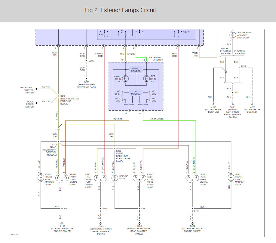

My dash-light and tail light are out. All other lights works, fuses are good light bulbs are good. Any suggestions? Thank you

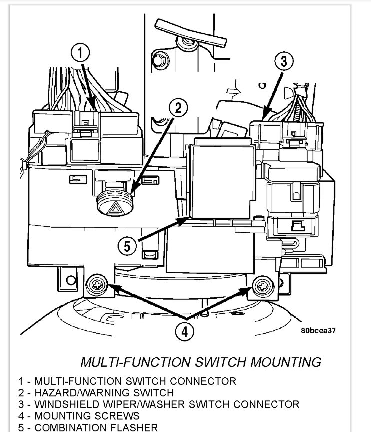

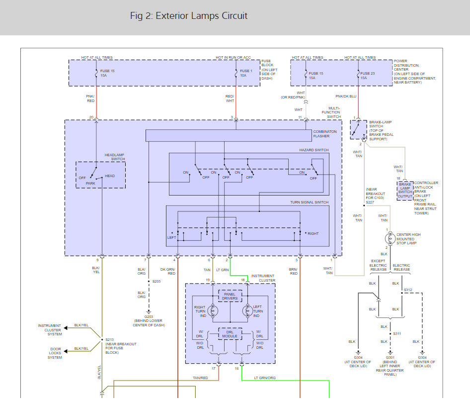

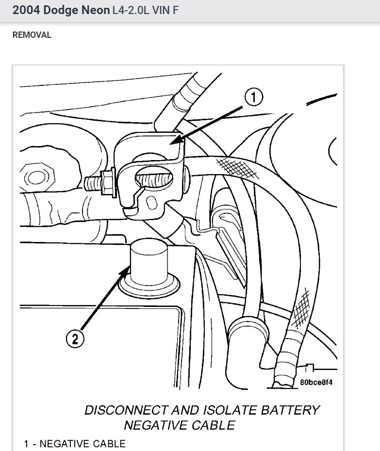

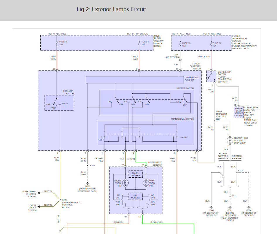

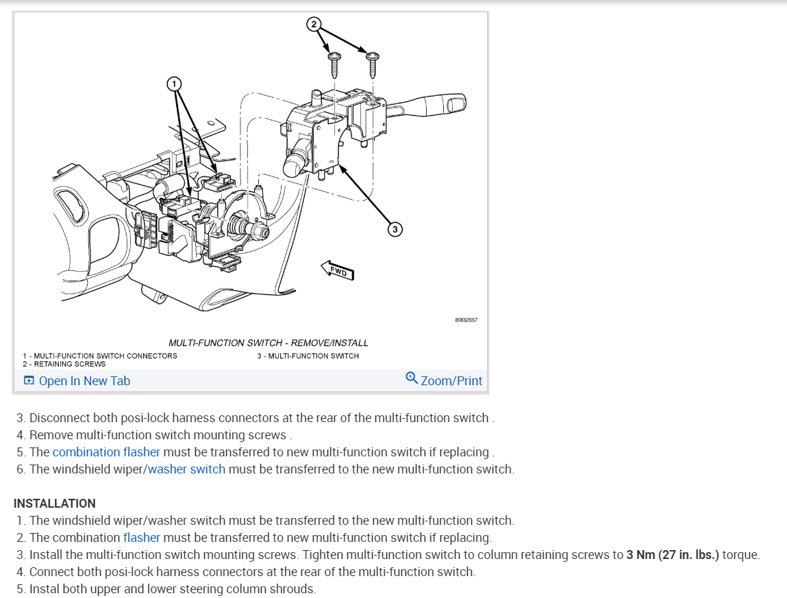

It sounds like you have a multi function switch that when out. but to be sure here are the wiring diagrams and a guide to help us test the power input and outputs of the switch and how to change the switch out:
