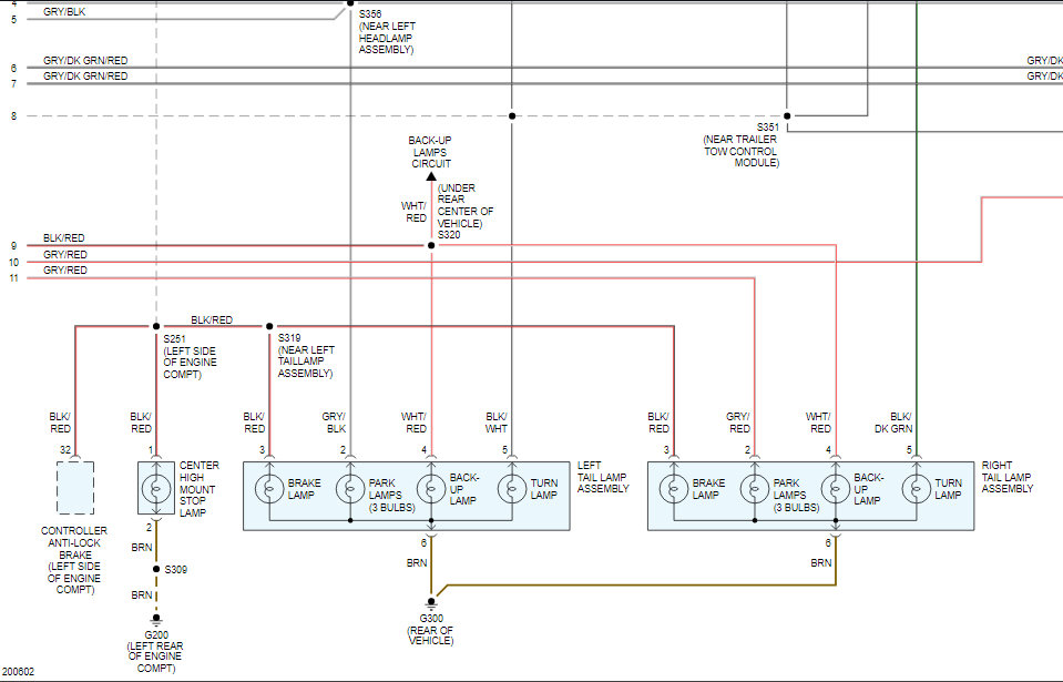

I need to replace my circuit board on the taillights and need the wiring diagram along with tips on how to remove the old one.It looks like it has 4 different wires on separate connectors going into the circuit board.

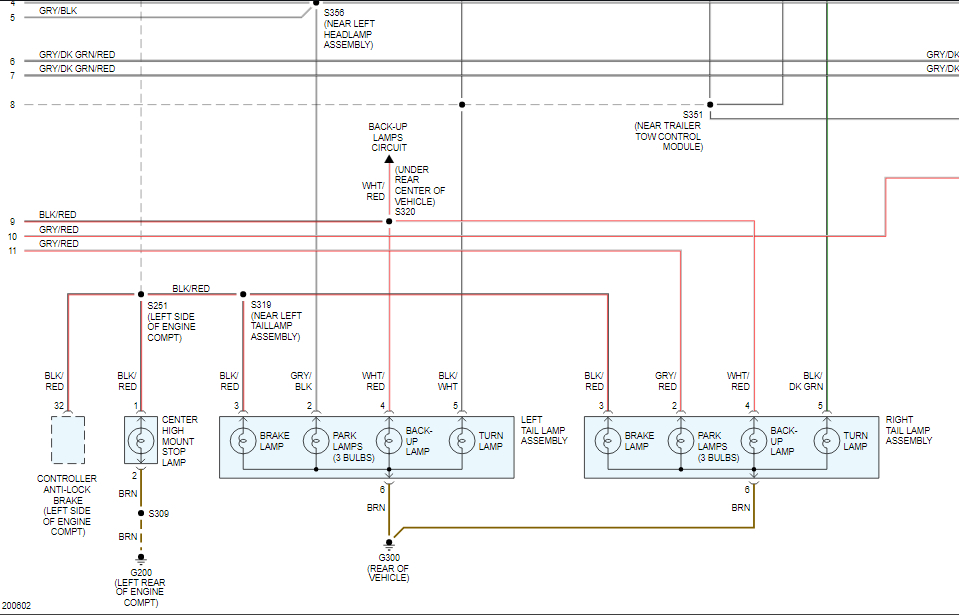

I've attached a picture below of the taillight diagram you requested. As far as wire removal, Is the circuit board soldered? If you want to release wire from a connector you can buy a tool or improvise by using an unfolded paper clip.Hope this helps and thanks for using 2CarPros.
