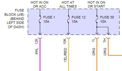

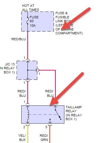

1. the fuse to my tail lights keep going out . . why ? where is the problem. . .
I found myself driving on the freeway on a rainy night with no tail lights. . .please help
2. I can't find the on the fuse box a decrpition title for dashboard lights. those also went out. but have not replaced fuse because I don't know which fuse it is please help. . .

see pics for taillights it may need to be scanned as it has a module for it as well as fuse and relay. Check out the images (below). Let us know what you find.

This will happens when one of the bulbs or bulb sockets has melted causing the fuse to blow, this is very common. Here is a guide to help you fit it.
https://www.2carpros.com/articles/no-tail-lights-exterior-running-lights-tail-lights-out
Please go over this guide and get back to us.
