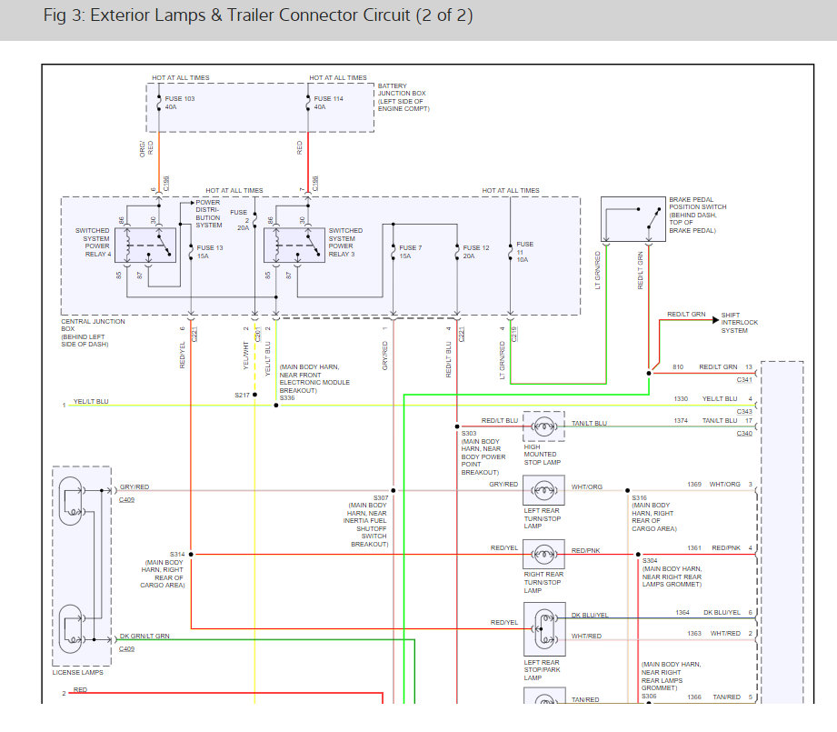

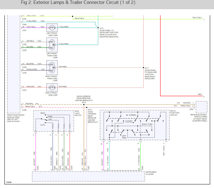

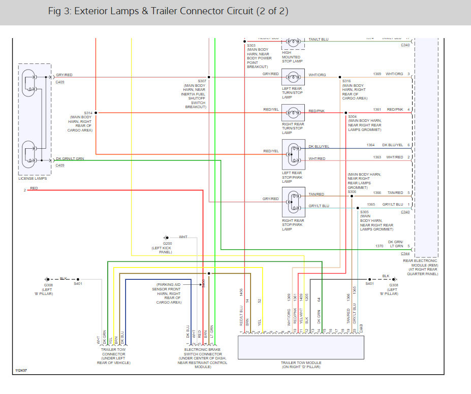

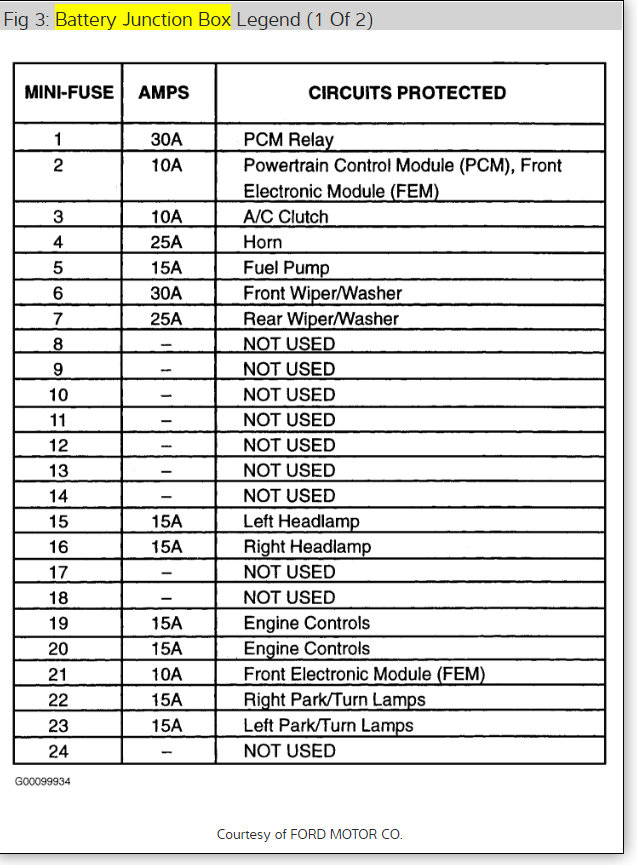

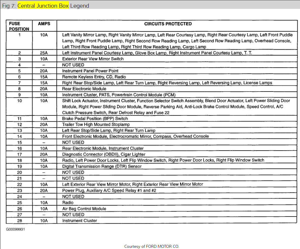

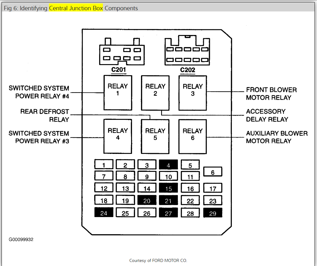

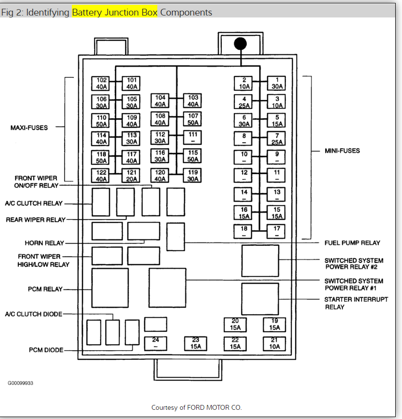

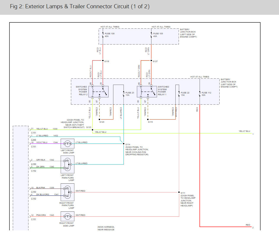

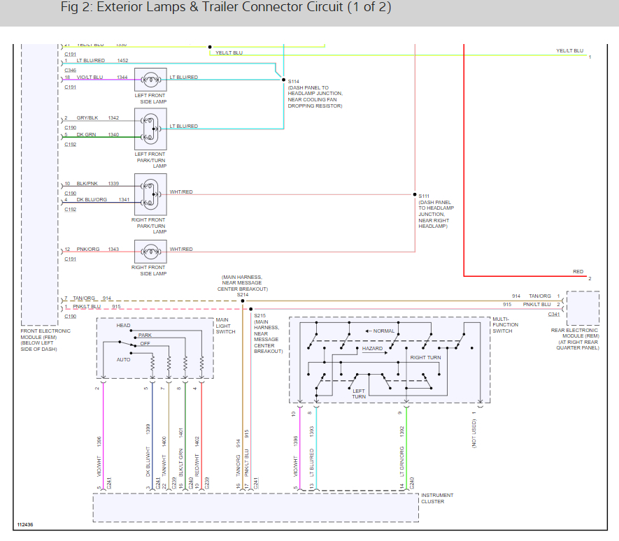

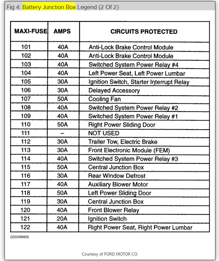

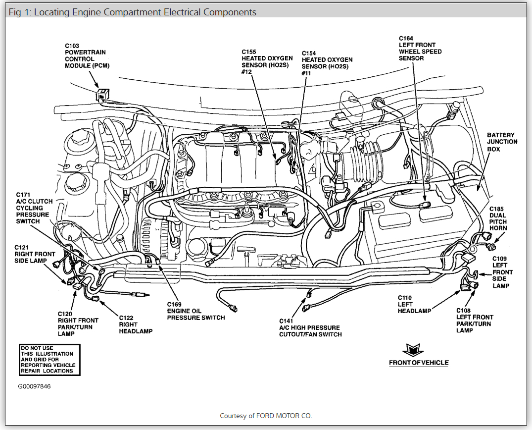

No taillight, no signal light, no park light, no brake light. please help
Sep 27, 2019 at 4:03 AM
  • 55,711 POSTS
There are 2 fuses and 2 relays that run the system that need to be checked. here are two guides and the fuse and relay locations as well as the blinker and running light wiring diagrams so you can see which fuses and relays to test in the diagrams below:
and
