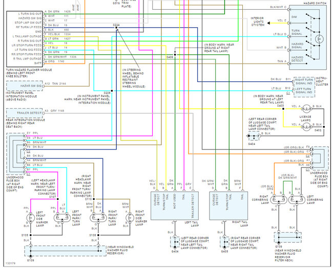

The taillights are not working, can I get the taillights wiring diagram?

I've already checked all my fuses and bulbs, they're all good. I just don't have no taillights when I turn on my switch. I checked the switch with multimeter it's good. so, I was just wondering if you could help me with the taillight wiring diagram. maybe it's a wire problem? Thank you

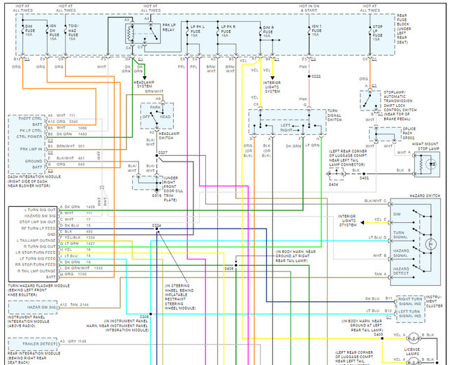

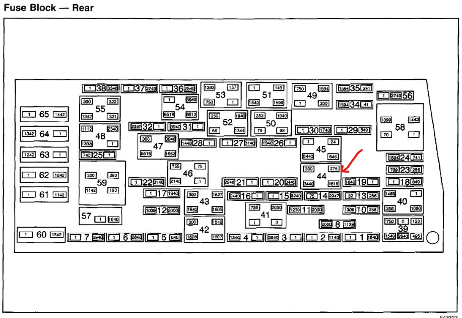

So, there is a taillight relay I would swap out or test which this guide can help with:

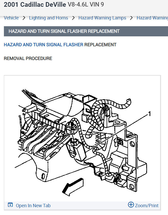

Also, there is a turn/hazard module that can do out and cause this problem as well. Here is the location of the flasher module and relay (rear fuse panel) so you can check it out and I have included the taillight wiring diagrams as requested. Remove the left knee bolster, turn/hazard flasher module (1). Check out the images (below). Please let us know what happens.
