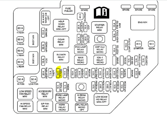

drivers side taillight not working.. do turn, no flasher.

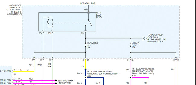

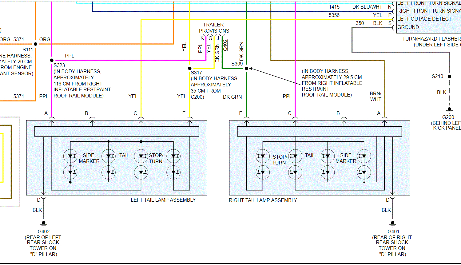

I need to verify something. Is it only the left taillight that is affected? Also, does anything on that light work? For example, brake lights, back up light, and I'm not sure if the turn signal works. If it doesn't, does the front left work and flash fast? Have you checked the bulbs?
I attached a pic below. Take a look at them. One shows the relay for the lights and the other the wiring to each of the rear lights.

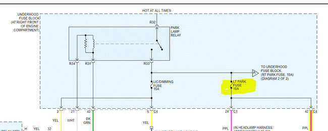

It seem that the entire light is an issue. I need you to check for power to the purple wire at the light. You can use a test light to do this. Also, confirm there is ground to the black wire. See the pic above.

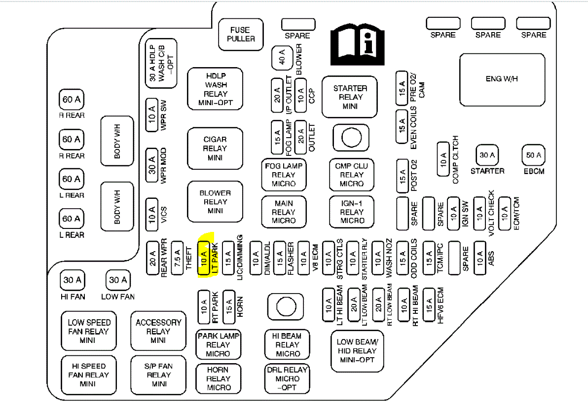

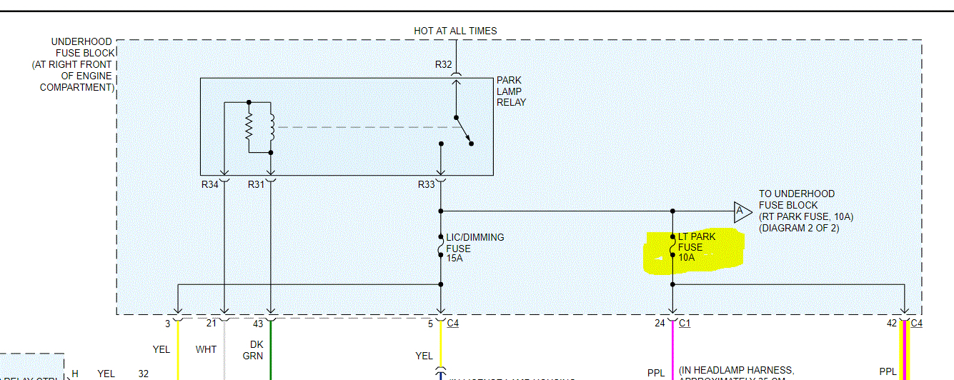

If there is no power and you do have continuity to ground, check the fuse in the fuse box under the hood. See attached pic. I'm not sure how it would be bad if the front works. However, anything is possible.
