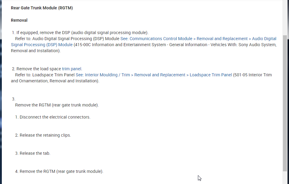

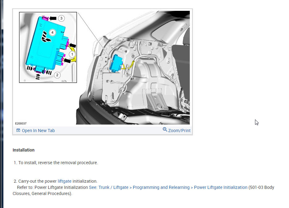

I would like to know where to find the tail gate control module. I did not see it under the covers on the tail gate.
Nov 21, 2020 at 10:31 AM
This is located in behind the left quarter panel. That is in the rear of the vehicle on the driver side.
I attached the info from the manual. Let us know if you need more info. Thanks

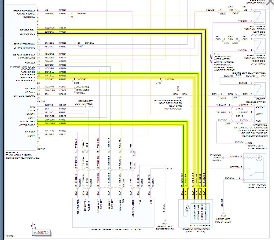

I changed the control module but it did not fix the problem. The tailgate will open when pressing the button on the dash but not the key fob or foot motion or button on the tailgate itself. Any ideas?
Dec 1, 2020 at 1:22 PM
JONNYB1963
  • 263 POSTS
I thought I would chime in here. When you replace the RGTM it requires programming. Once it is programmed, there is an initialization procedure that needs to be completed as well. Most people do not have the tools to program these modules and must be completed by a dealer, or someone who has access to a Ford diagnostic tool as well as the OEM software load for that module.
Regards
Jon
