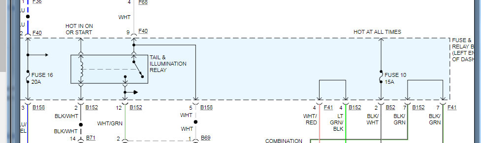

location needed for the issue listed above.
Oct 30, 2020 at 10:40 AM

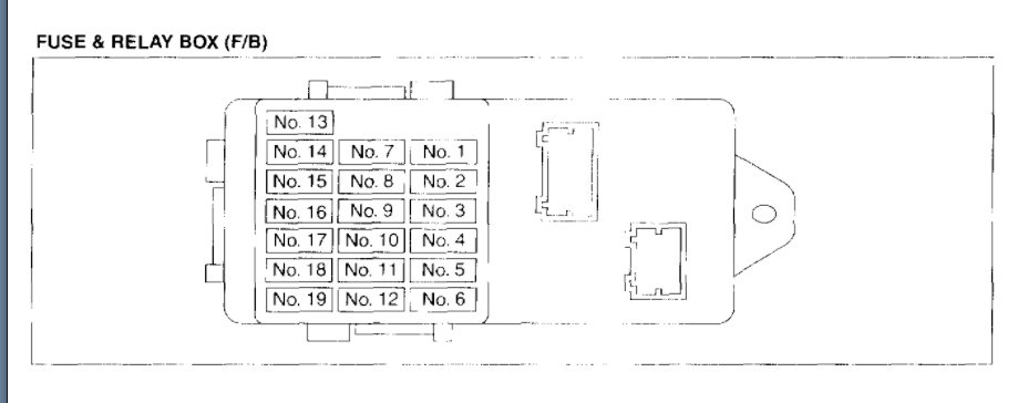

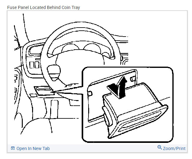

It is located in the fuse box behind the coin tray. I attached the info for it. Unfortunately it did not tell me which relay but there are only two in that fuse box so it is one or the other.
Let me know if you can't figure it out and we can dig deeper. Thanks
