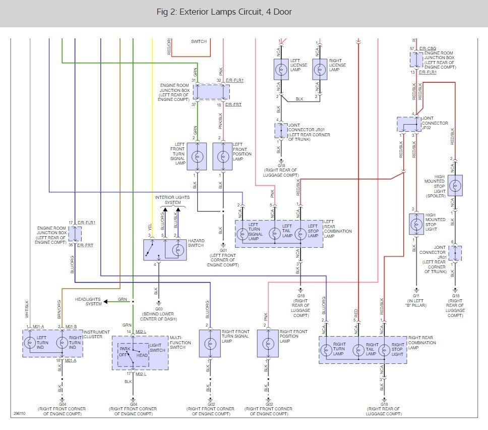

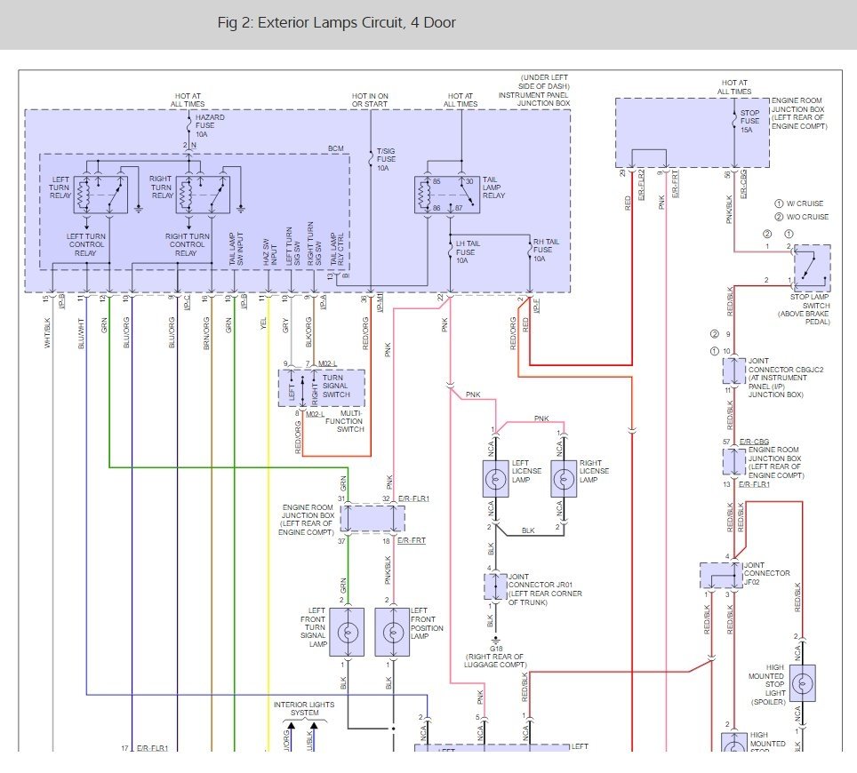

All my tail and brake lights are not working? Nothing when I press brake and just no lights for tail lights either have looked at the fuses not sure if I am looking at the right ones? If you could give me a picture of a diagram which fuses they are? I have checked all the bulbs except the top one it is in the spoiler and I cannot get to it. It is a 5 SX model.
Apr 29, 2017 at 12:45 AM
  • 55,770 POSTS
There is a tail light relay and some fuses running the system . here is a guide and a wiring diagram that will help you get the problem fixed.
and
Please run some tests and get back to us so we can continue helping you.
