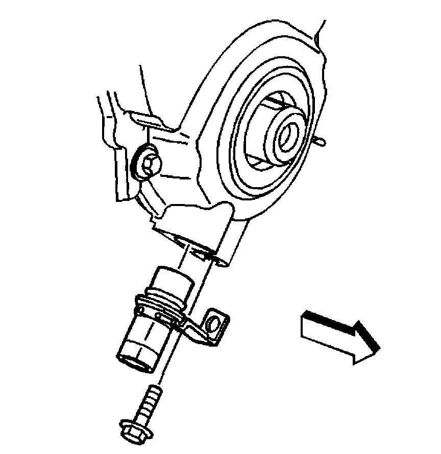

I turned the SUV on, it starts and then it hesitates to stay on (5 seconds) and then shuts off. the idle is rough. I have fuel pressure and the pump is fairly new and working. Haven’t found a vacuum leak anywhere. EGR is clean. Throttle body is clean. Air filter/MAF's is clean. I checked my TPS. I’m stuck and need help.

So I have no check engine light, no codes, no smoke and fuel pressure is with in spec. Also I pulled the crankshaft sensor out. It was dirty. So I cleaned it up and it looked good. I put it back in and tried to start the vehicle.. now the SUV cranks and doesn’t run. Also I noticed the crankshaft sensor looks a little different then the replacement.. maybe it’s original? Not sure.

Anthony: Did you replace the OEM sensor? If so, how was the new one different? I'm going to start by adding the directions specific to your vehicle. Take a look through them and let me know if it is what you did or if you missed anything.

CRANKSHAFT POSITION (CKP) SENSOR REPLACEMENT
REMOVAL PROCEDURE
IMPORTANT: The CKP System Variation Learning Procedure will need to be performed whenever the Crankshaft Position (CKP) sensor is removed or replaced. Refer to CKP System Variation Learn Procedure.
CAUTION: Refer to Battery Disconnect Caution in Cautions and Notices.
pic 1
1. Disconnect the negative battery cable.
2. Raise the vehicle.

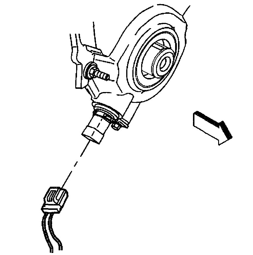

3. Remove the CKP sensor harness connector.
pic 2
4. Remove the sensor hold down bolt.
5. Remove the sensor from the timing cover.
6. Inspect the sensor O-ring for wear, cracks or leakage.
Replace if necessary. Lube the new O-ring with clean engine oil before installing.
INSTALLATION PROCEDURE
IMPORTANT: Make certain that the Crankshaft Position (CKP) sensor mounting surfaces are clean and free of burrs before installing the CKP sensor.
When installing a crankshaft position (CKP) sensor make sure the sensor is fully seated and held stationary in the front cover before torquing the hold down bolt into the front cover. A sensor which is not seated may result in erratic operation and lead to the setting of false codes.

1. Install the sensor into the timing cover. Lube the O-ring with clean engine oil before installing.

3. Install the CKP sensor harness connector.
4. Lower the vehicle.
5. Connect the negative battery cable.

I need you to check for spark to the plugs. Also, if you have a live data scanner, connect it and see if there is an RPM signal when cranking.
