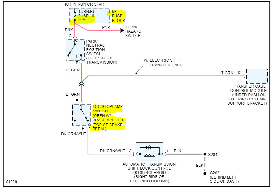

The idea that you simply changed the fluid wouldn't have caused it. Something has either come disconnected or caused a fuse to fail.
If you look at pic 1 below, I attached the wiring schematic for the shift interlock circuit. I need you to first confirm that the brake lights are working. The shift lock actuator is powered through the brake light switch.
If they aren't working, check the fuse I highlighted in the picture. In addition to checking the fuse, confirm there is power to and from it.

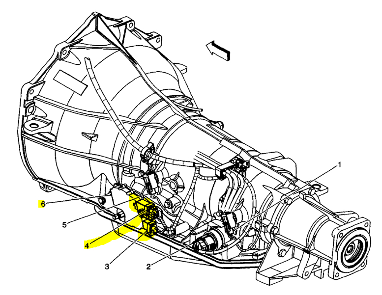

If you look at pic 2, it shows the location of the park/neutral switch. Check to make sure nothing has come disconnected or was damaged.
Let me know what you find.,

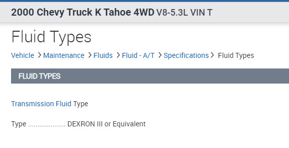

The vehicle originally had Dextron III, but the Dextron 6 covers it. No problem with that. (See pic below)
