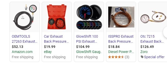

Good afternoon,
Yes, it could be but needs to be tested to confirm.
A back pressure test will confirm if the catalytic converters are clogged. You remove the O2 sensor and insert the gauge. If it read above 1 pound, the catalytic converter is clogged not allowing the engine to breathe.
