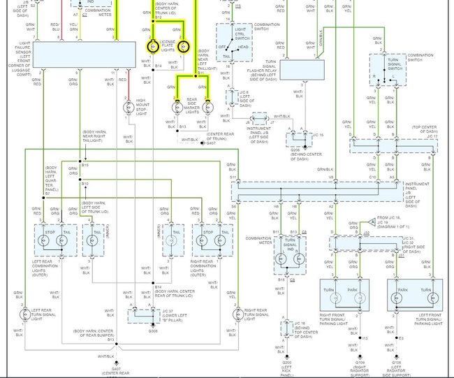

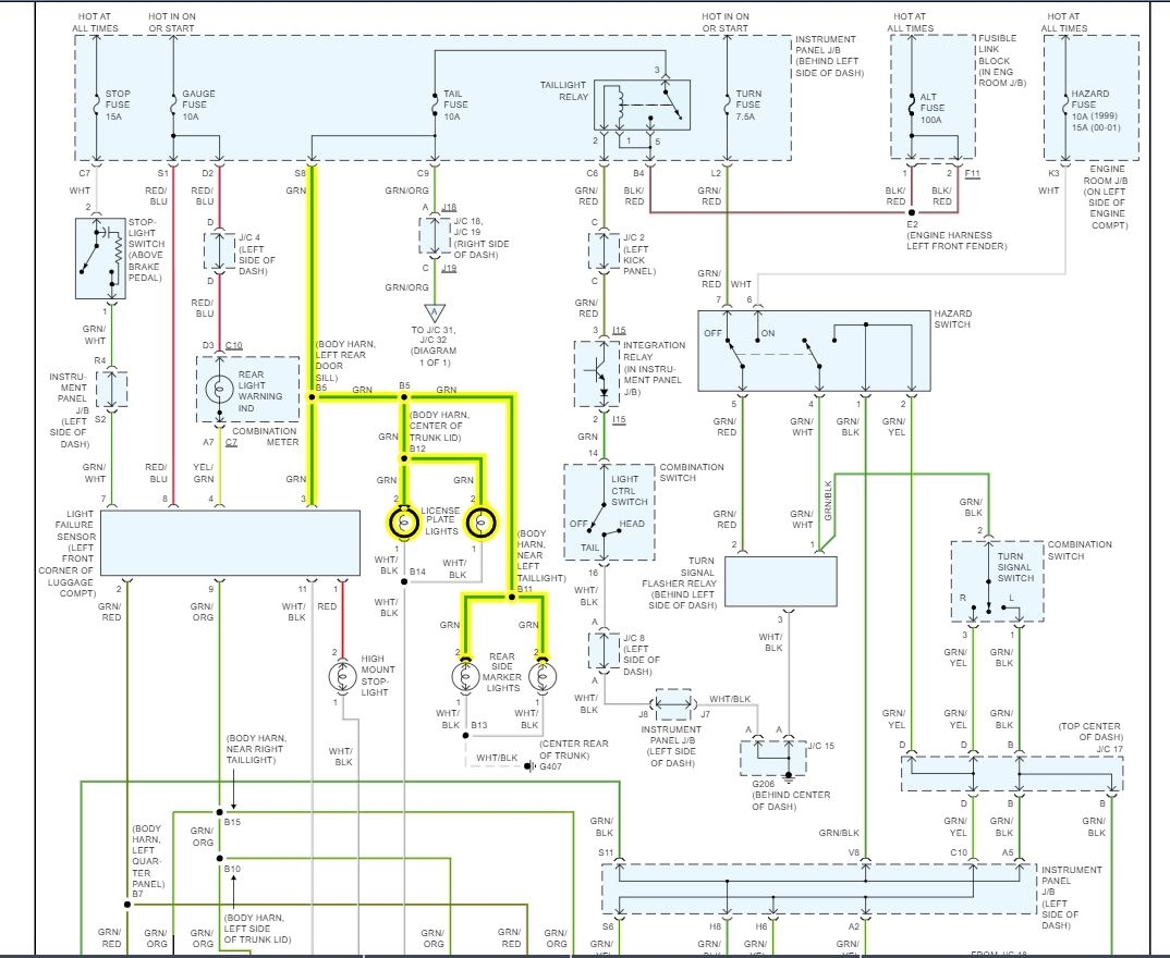

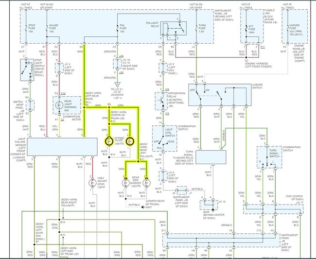

I replaced my tag lights and I replace my fuse I checked the sockets with a meter and they are not getting any electricity any suggestions other than splicing wires?
Sep 20, 2016 at 2:26 AM
Good morning,
I attached a diagram of the tag lights for you.
The tag lights are spliced into the side marker lights. If the side marker lights work, then you have a wiring issue with the tag lights. You will need to uncover the harness and inspect for the broken wires.
