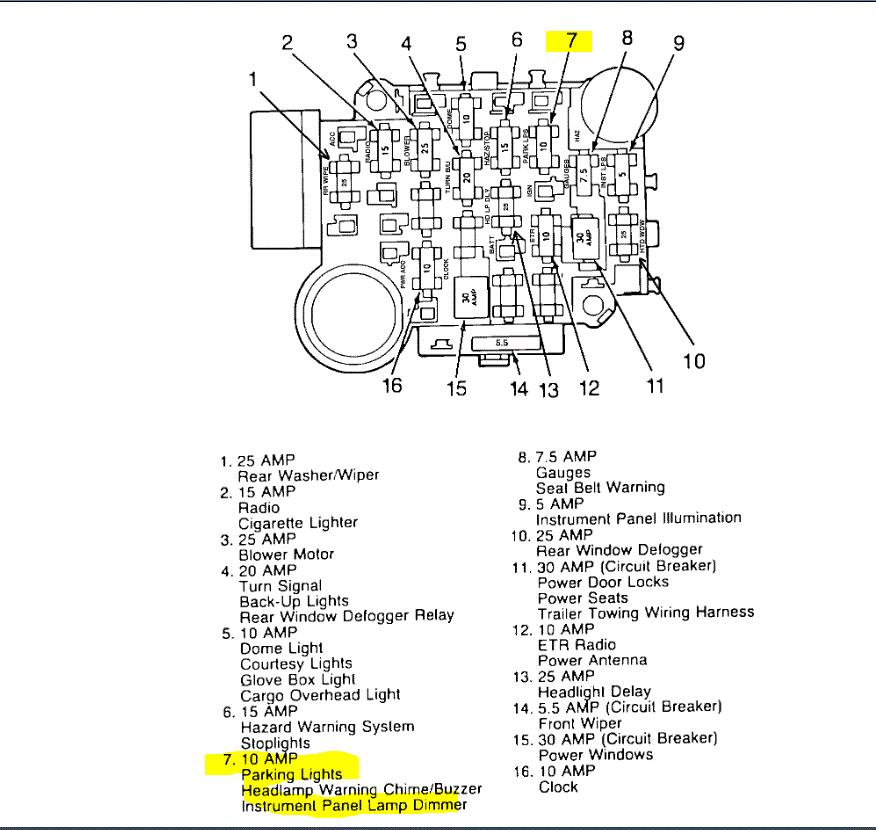

My dash light for gauges quit, then my taillights and tag lights quit working. also bulbs are good but can't find right fuse or problem.

1988 Jeep Cherokee Laredo 4×4 6 cylinder.

The fuse box is under the dash on the left side. Actually, right above where you left foot would sit.
I attached a picture of the fuse box and highlighted the fuse to check. When checking, make sure there is power to the fuse also. Here are a few links you may find helpful.
___________
Within the past year, I sold my 1987. Make sure when you check the fuse, nothing looks overheated and the fuse fits snugly into the box.
Let me know if this helps.
