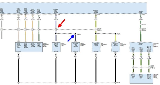

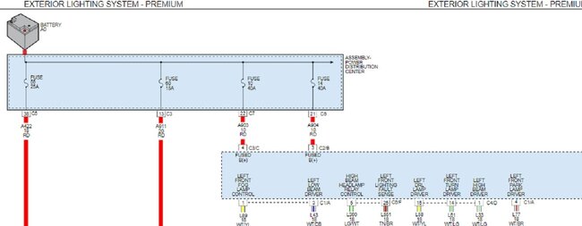

My tag light is out I tried hooking a new tag light up to it not getting any power to the wires cannot find the proper fuse.

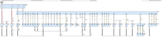

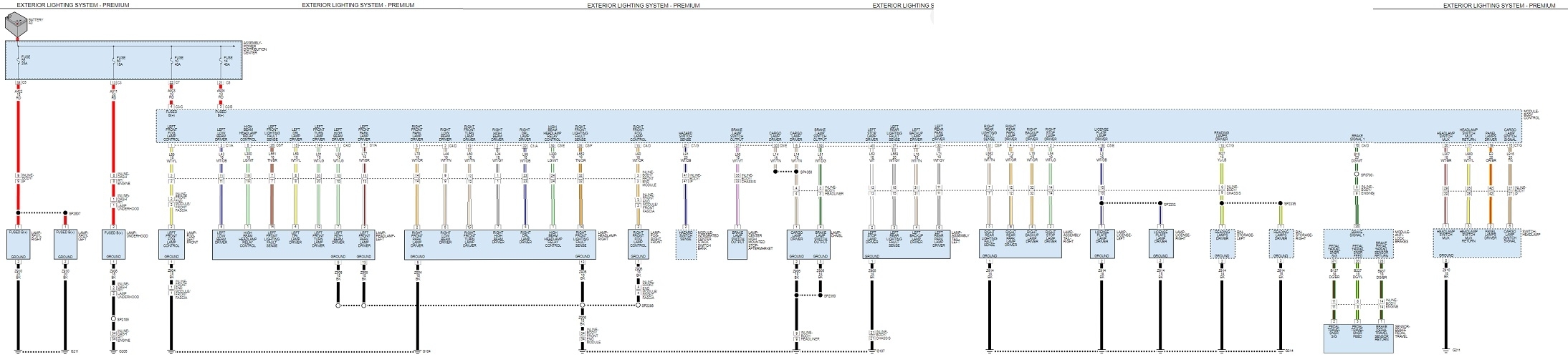

This diagram is for the exterior lighting, but it's too hard to read. First, try to copy and paste it into a typing program where it can be expanded. I use MS Word.
The second diagram is expanded to show the two fuses. They are okay because a lot more would be not working if one was blown. The third diagram is the expanded part showing the two license lamps. If one is working and one is not, suspect a corroded splice, SP2232, (blue arrow).
